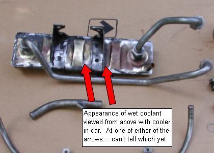

there was a discussion about these heat exchangers recently, there was a picture attached to Najs' response
http://index.php?topic=4940,cooler,250

I also see where the appearance of the wet coolant is from my view from above with the unit in the car.... see the annotated picture I've attached.
Download Attachment: Oil Cooler.jpg
24.32 KB
