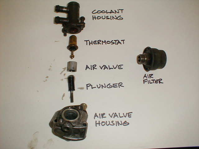

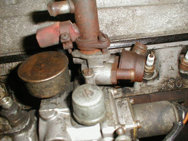

The #2 plug has probably fuel fouled due to the rich mixture. The warm up device on the pump is probably stuck in the rich position from sitting too long. This can be freed up.
Check to see if the slide valve in the unit is stuck then replace the fouled plugs.
Download Attachment: warm up device.jpg
60.08 KB
Download Attachment: warm up device parts.jpg
50.92 KB

Hello Merrill,
Yes you can check the functioning of the device by using a rubber hose as a stethoscope and listen at the air filter on the injection pump, to see if the suction noise goes away as the engine warms up.
If you do need to remove it, no gaskets or seals are required. I use a little gasket shellac on mating surfaces to make sure things seal up.

« Reply #7 on: May 21, 2006, 08:21:00 »
Cleaned up the warm-up device per Joe's excellent pictures.  There was some rust and scale in the water chamber, but everything seems to move freely.  Put it back together, warmed it up, and took the car for a two-mile drive.  All of the plugs have a good burn.
The car seems to be running better as it gets more time with fresh gas.  I could still smell the stale gas when I had the warm-up device apart.
