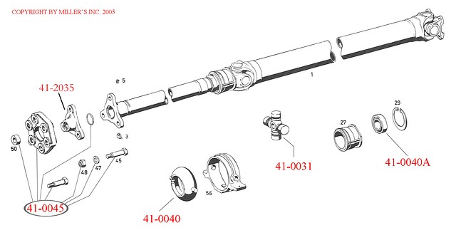

Hello James,
Looking far a simple cause first, check the bolt connections at the driveshaft/differential connection. Check the flex disc bolts and nuts for tightness, check the center carrier support for loose bolts, lastly remove the flywheel cover at the back of the oil pan at the transmission (the vertical cover), the flywheel/torque converter bolts are in here make sure they are not loose.

I would check the univeral joint.   I have had this happend to me before (other cars) and that what was causing it.

Ok. I will have a look. Am I basically looking at the connections shown here?
(courtesy of Miller's)
Download Attachment: yb.jpg
33.7 KB

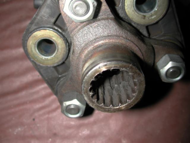

Also get your mech to check the drive flanges on the diff and auto box.
This one was loose and got kind of chewed up:
Download Attachment: RXB07.JPG
35.63 KB

naj, Did the M26(?)nut on the tranny shaft come loose?  Just had one on a 190E come loose(even being peened) and screw up the spline cuts on the yoke piece like the one in your pix.
Yes, the nut was loose and the lock ring had worn out. Also, by this time, there were no threads left on the nut either.

Naj, Did you put Loctite on the nut?  on the spline teeth?  peen the nut?
Originally posted by naj
Hi, Glenn,

Glen,
This flange is from a friend,s car.
A new nut was required and threads on the output shaft cleaned with a thread chaser.
Yes, loctite was used on the threads.
As you probably know, the locknut on the pagodas is only a 6ish mm deep ring with 4 slots. There is a lock ring behind it and you lock the nut by punching the lock ring rim into the 4 slots (or less).
No loctite on the splines.

Naj, All I have is M26 nut tight on the yoke piece (with the spline).    Is there more?  You say a 'lock ring'?  The lock ring peens into the dimple  on the tranny tail shaft?   That sounds better than the nut on a floating yoke?  Ah, the mystery.
Glen,
