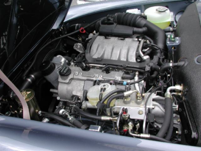

One of these if your wallet can stand it:
Download Attachment: Mechatronik1.JPG
48.47 KB
Download Attachment: Mechatronik2.JPG
32.81 KB
http://www.mechatronik.de/en/index.htm

That's really nice NAJ!! They made an amazing job on these cars! Eventhough I don't know how much mechatronik charges to restore the car, I would prefer to do it myself! :)
Would you recommend any specific engine ? A C-Class 240 engine year 2000 maybe?
I would really appreciate your help! Thanks again!
Re: Which new Engine for my 280SL 1969 Pagode?
« Reply #4 on: June 10, 2006, 17:02:53 »
The first one they did was with a 280 V6 engine/gearbox out of a C Class. There is an article about it in one of the Mercedes Enthusiast magazines

Bigstar,
One of the nice improvments of the Mechatronik car is that the A/C is integrated into the dash and there is no Frigiking unit to hang down from the dash.  Also, the 5 speed transmission is mated to the V6 and is quite nice.  Heated seats, automatic windows, etc. don't hurt either and the audio system is strong.  I have driven 2 of the Mechtronik cars and they have figured out how to update the classic to a fully functional modern car while retaining the overall look and feel of the original (until you open the hood).
