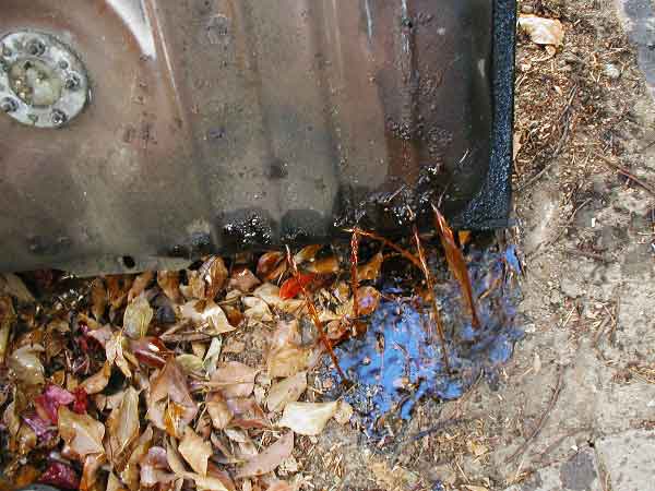

Hey Marti - - Others have yet to mention it, but our Pagodas are particularly prone to rust-through on the top side of the gas tank. Mine was an utter disaster area as you can see. There is no quick fix.  It has to be removed if you determine that there are holes in it. I think I remember that  a  replacement tank is around $800.   Or you can do what I did and send it to Tank-Renu in Ohio, for about half that amount.
Hope you are better off than I was , Larry in CA
Download Attachment: tank-holes1.jpg
37.22 KB
