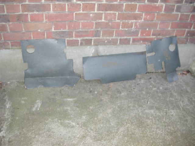

1.  Should there be an under dash cover, under the glove box area, when there is no air installed?  With the air-cond unit removed, it is now all "open" under the glove box area.  If yes, where is a good source for this piece?

These are the panels from a RHD car
http://www.sl113.org/forums/uploaded/naj/2004527181341_udash006.JPG

BTW, I too have the whole area above the passenger footwell open.  Does anyone know where I can get the under dash cover?  Does it reduce the road noise that enters?

Try www.kkmfg.com
They were selling them 2 years ago.  I believe they are only available in black.
