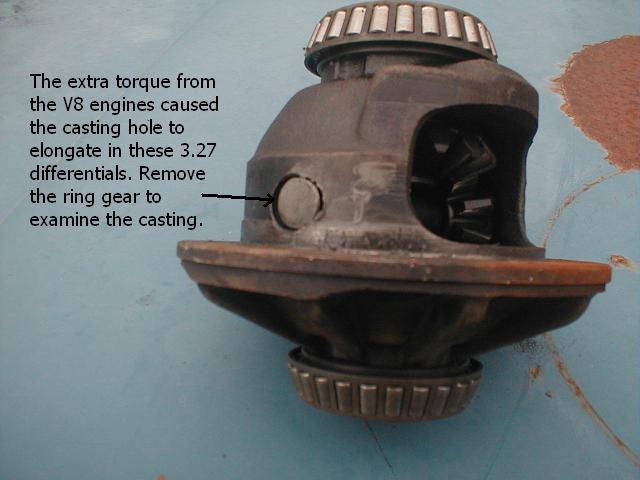

Hello Trice,
Those guys as Star are very reputable, but I can imagine very good and a bit pricey also!? I am always looking for these 3.27 axles but have none at this time. You must be aware of a potential problem with these and check it before installation. The large pin which holds the spider gears in the casting wears its mounting holes oblong causing differential "slop and clunk"! This seems to be characteristic of this unit which is subject to the power and torque of the big Mercedes 4.5 engine from which it came. Almost half of these units with high mileage will have this wear.

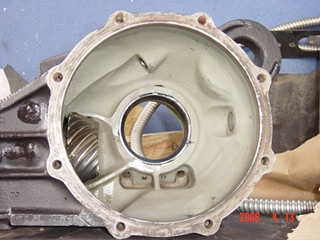

Dear friends,
I am attaching two pictures of an open differential case 3.27 ratio in order to try spotting where the problem with these differential is.  Joe we beg your help here.
regards

Re: 3.27 diff conversion
« Reply #10 on: April 16, 2006, 17:06:01 »
Hello Juan Tomas,

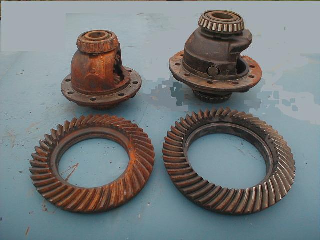

Hope all is well with you and the pagoda.  Here are some photos of the 3.27 differential problem to look out for. Hope this helps.
Download Attachment: diff casting.JPG
36.31 KB
Notice the physical difference in size of the standard six cylinder differential and that of the V8.
Download Attachment: diff2.JPG
38.96 KB
« Last Edit: April 16, 2006, 17:08:57 by ja17 »

« Reply #11 on: April 16, 2006, 22:26:51 »
Joe,
Thanks a lot for these pictures, they clarify where to look for problems.  It seems that my 3.27 Diff is in good condition.

« Reply #17 on: May 07, 2006, 22:02:50 »
The 3.23 rear differential casting is physically larger than the six cylinder differential. However it fits and mounts without problems except that the "U" shaped cooling tube, not used on the six cylinder versions, must be removed and plugged. Standard oil pan drain plugs are the correct size and thread to use for plugs.
The 3.23 differential is normally found in the USA W108.067 and W108.068 chassis cars (as mentioned 280SE and SEL sedans).  The Euro versions with the 3.5 V8 engine had a 3.46 ratio.
Be sure to know how to check for damaged spider gear castings in these units (see previous post).  The higher torque of the V8 engines seem to damage quite a few of these.
