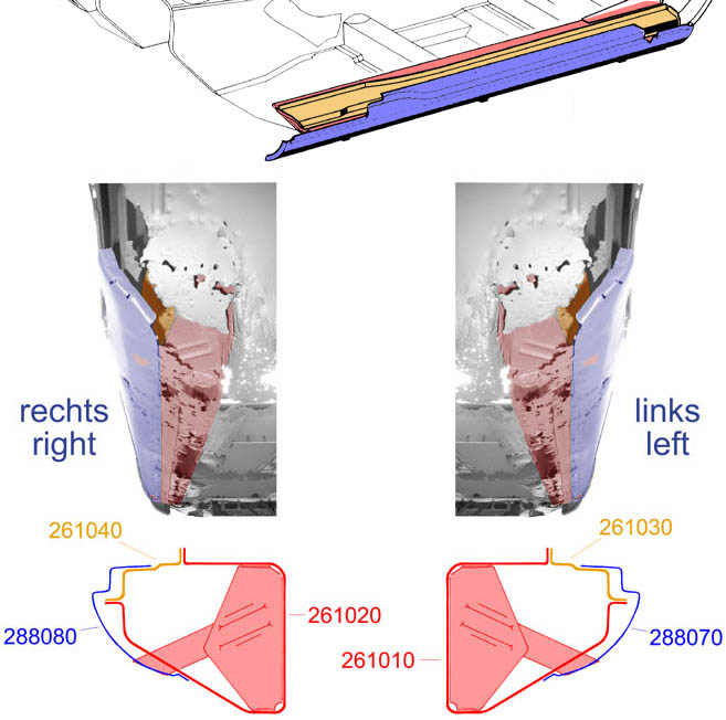

Interesting Jeff. Maybe I am confusing rusted rocker areas with something much more sinister. In looking at another visual aid, the SLS catalog, it shows basically three parts of the rocker. The cover, the frame rail and the top piece. Patching/replacing these would be much more, wouldn't it?

This is really interesting.  I never knew that there are three separate pieces that made up the rocker.  Are all these parts held together by screws and can be replaced separately if one desires?

James,
One of the parts they replaced was the cover #288070.  They also replaced the other side.  Both covers are screwed in place and can be removed.  Plan on breaking several of the screws as some are rusted in place.  You will have to drill the screw out and replace it.  The two piece frame rail assebly is welded in place and it is not easy to replace.  I hope this answers the question that Louis asked.

« Reply #6 on: April 26, 2006, 15:09:42 »
The only screw on part is the outer rocker cover, The other two pieces are welded together and form a box section that runs from the rear of the front wheel well to the front of the rear wheel well, They along with the trans tunnel are the main structure of the car, they are welded to the seat cross member, rear cross member, rear bulkhead, cowl sides and a dozen or more other places. The inner part of the rocker is the vertical area that the carpet is glued to in the interior. Pic of a Pagoda without a rocker

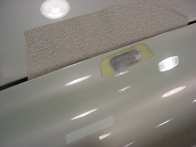

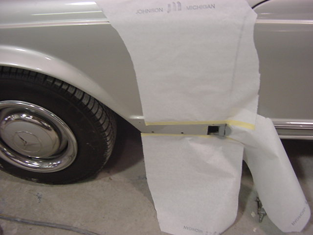

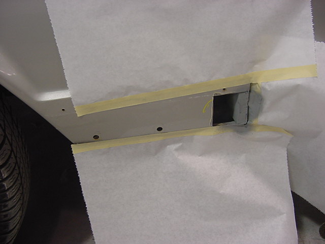

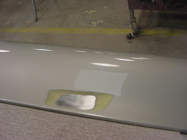

After my car was detailed, I noticed a paint bubble less than Ø0.25" behind the driver side front wheelhouse. Further investigation led to a half dozen small areas that I had professionaly taken care of (rust & dings) by a reputable shop in my area. Cost was just under $4,000.00. I figure this will buy me three to four years before I must take the big plunge. Some pic's.

« Reply #12 on: April 30, 2006, 06:19:48 »
Mike,  Have a look at your inner fender gasket.  The rust you took care of was from the inside out.  Somehow moisture was able to get to the underside of the fender.  I suspect the gasket.
