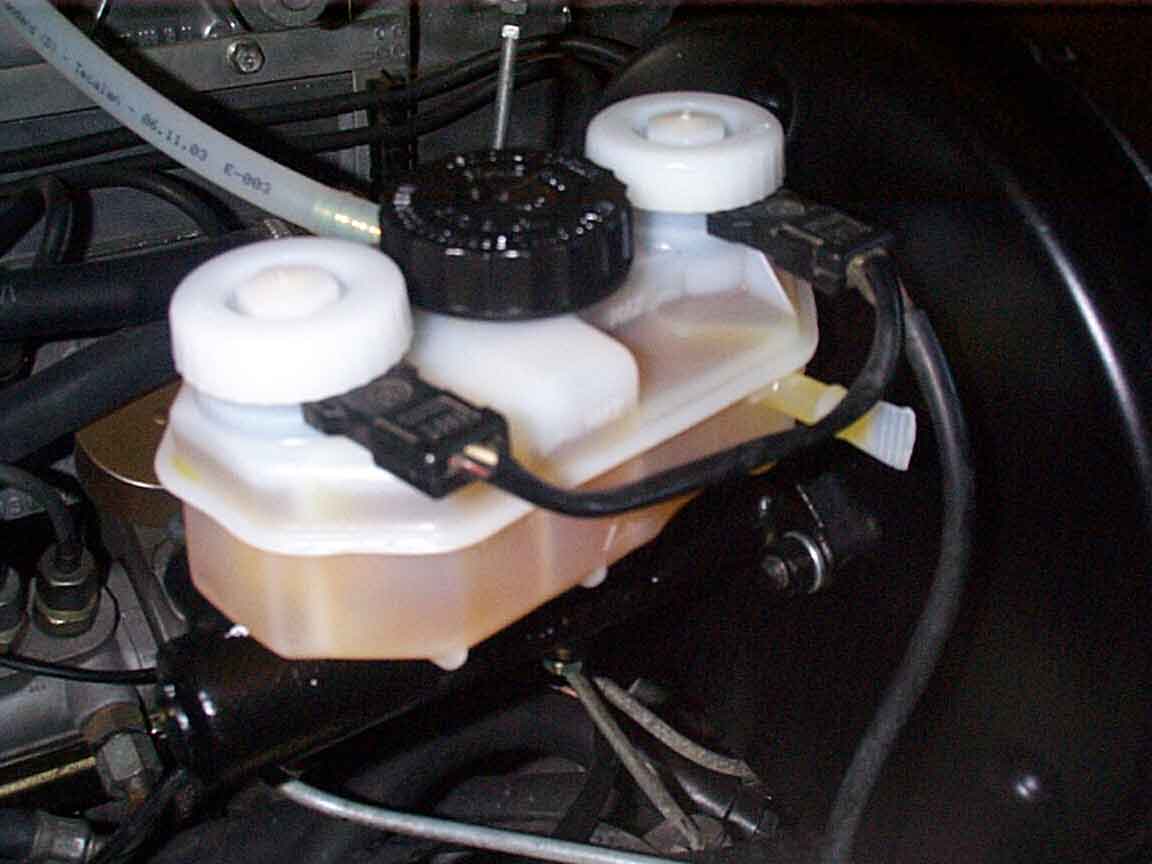

« Reply #2 on: April 28, 2006, 06:25:38 »
Hi Matt,
I also replaced mine.  New unit has been re-designed.
See attached pic of my unit installed.
Download Attachment: new_res.jpg

Re: did I get the right reservior?
« Reply #4 on: April 28, 2006, 12:07:02 »
So to me, it sounds like Matt needs an earlier reservoir but got a later one. Both JPs and Bob's would fall into the later version.
