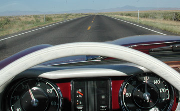

« Reply #2 on: April 26, 2006, 22:50:32 »
Larry,
I also have a '66 automatic. As you can see from this photo, at about 3200-3300 RPM my speedo reads exactly 110. ;)  Of course, this about 68 MPH.  52 MPH at 3000 RPM sounds awfully low.
A good hand-help GPS unit is an amazingly accurate speedometer, and is what I use to do speed checks.  If you have access to one, it might give you some more information.
-David Pease
