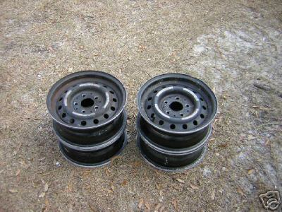

Got my hands on the following.
The wheels are stamped 1234991302 Lemme and 5 1/2J x 14 H2.
These have come from a 82 240D.
