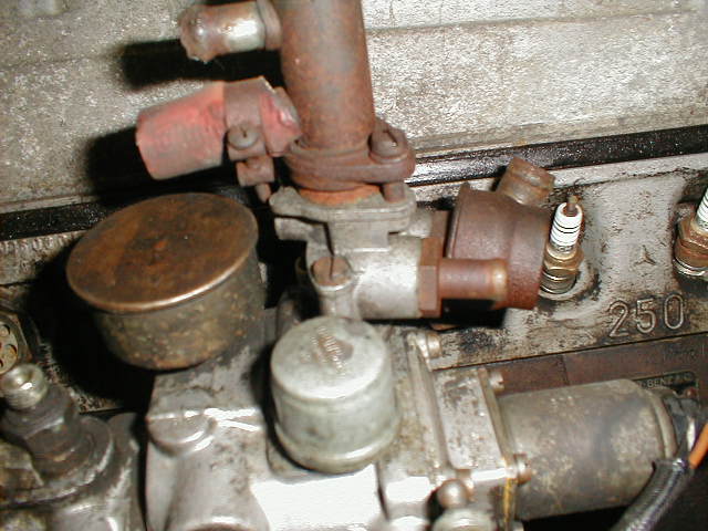

Here in sunny California our winters are very mild and so far this has worked well. All I had to do was find the leaned out "sweet spot" by trial and error. Turn the screw in to lean out the mixture - - then tighten the lock nut. I would not recommend trying this unless you have tried every conventional solution first. Regards, Larry in CA

Re: Fuel injection pump 230 SL
Reply #4 on:
March 25, 2006, 19:54:39 »
Good One , Lurtch..
Now, get a lever on there with a choke cable and you can run it from the cabin....a manual WRD...
Reply #5 on:
March 26, 2006, 06:21:48 »
Hello Lurch,
Yes this is definately a nice simple temporary fix for a faulty WRD.
George, yes I assumed lurch had the later configuration.
