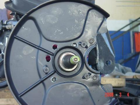

I am trying to post a photo but mine is bigger than 80Kb any help on how to reduce the size of the picture to be posted by this forum?

Finally it came out. this is the picture I wanted to post. in it there are two modifications to the original backing plate in order to gain more fresh air for the vented rotors.
Download Attachment: new image1.JPG

Re: 108 sedan vented brakes on 113 pagoda
« Reply #5 on: March 06, 2006, 20:13:46 »
Juan,
I don't understand why the holes are near the center of the plate.  Are there holes near the center of the rotor?  I thought the holes were on the end (radial?) and simply created additional surface area to dissapate heat.  Not realy an "air flow", just more surface area.
« Reply #6 on: March 07, 2006, 20:58:56 »
Rodd,
To my knowledge, the air flow is what you want in a vented disc. It is suppose to work as an impeller in a water pump. It moves fresh air from center to outside radially.
« Reply #7 on: March 08, 2006, 06:28:17 »
Originally posted by domingo_santo
Rodd,
On modern sport cars vented and drilled rotors are specify left or right.
Juan Tomas Santos
Dominican Republic
1982 911SC
1972 350SL
 That is correct  on both concepts.
   Directional flow rotors are quite common now. You can tell by looking down the rotor cavity/slots. If they angle  off-center of the rotor , they are directional and r/l specific.  If the slots are straight with C/L of rotor , they are not drirectional.
The more air you get at the center , the more flow gets expelled out the circumference .....no air in , no air out.
« Reply #8 on: March 08, 2006, 10:08:22 »
OK.  I guess I've never looked that close at a vented rotor.  It's been a while, so I apparently I just don't recall the holes near the center of the rotor.  Learn something new every day!
