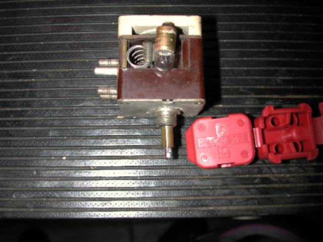

here's a picture of my blower switch from a 230SL. Don't know if they were used on the late 250s. Did you see the clear plastic bit when you had the knob off?
The bulb (same as other dash lamps) goes on one side and the light shines thru the clear plastic bit sticking out thru the spindle (and the hole in the knob).
A replacement plug [014 545 8528] is also pictured. Fits on the clock and blower switch and maybe other places?? Maybe not for the purists :x
Download Attachment: Htr_Blwr17.JPG
44.39 KB
« Last Edit: March 01, 2006, 13:06:25 by naj »
