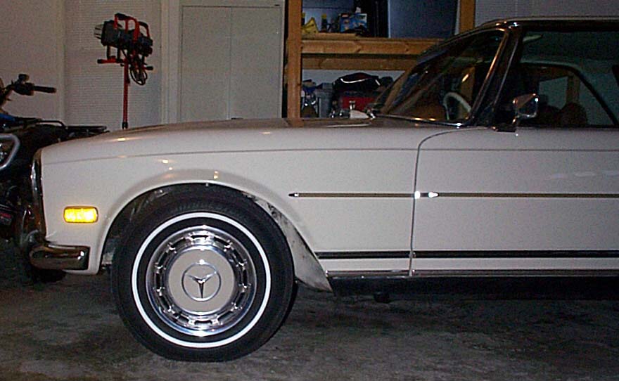

« Reply #7 on: January 21, 2006, 17:39:44 »
Update....
A while back I replaced my front spring pads with new 30mm pads.  While this did even out both sides, my car sat high, too high!
This morning, I pulled out both front springs and sawed off one spring ring from the top of each spring.  With one ring removed, my car now sits approx 2 inches lower in front.  While this may seem like a lot, the new ride height looks perfect!  I drove the car this afternoon, and I am very happy with the results.
The new height is 13.5 inches, measured from the center of the star on the wheel cover to the lowest point on the fenders.
Pic attached
Memphis, TN.
1997 E320
Download Attachment: 2.jpg
80.99 KB
« Last Edit: January 23, 2006, 19:06:40 by bpossel »

Re: Front Springs?
« Reply #8 on: January 24, 2006, 07:14:20 »
Bob, Thanks for the follow-up to an interesting ride height problem. Your solution was a very courageous one!     Jim Pancoast
