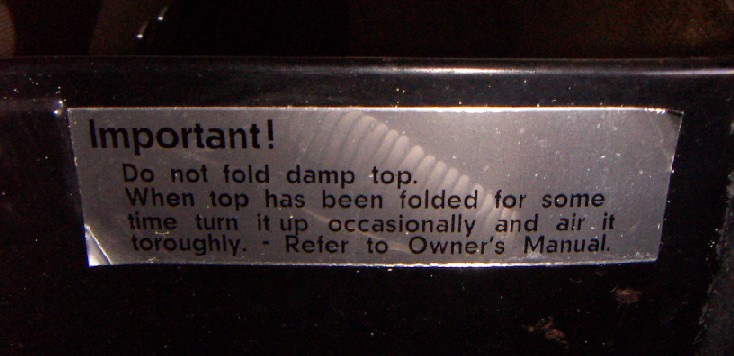

Also in addition to looking in the dashboard and under the seats for coins.  Look at the softtop instruction label inside the softtop compartment on the drivers side.  If the instructions are in french then indeed the car is a french version.  The other items can be changed out easily, but the sticker is often overlooked.  I have the german, french, english and international stickers.  I need to find them again.

Walter, the 1970 Swiss SL I used to own was specifically ordered with French books & stickers throughout (indicated on data card), but the soft top well had the standard multi-language sticker & it was clearly original.

How about if we do a poll and ask the members to check which language they have on their stickers and the delivery code(country of delivery).
Might be interesting.
Also would like to know if there is interest to photograph the various stickers with different languages on them and post them to the group.

Mine is in French-Canadian. (still looking for a laugh here..."toroughly"???) :D

Download Attachment: Soft Top Instr Sticker.JPG
