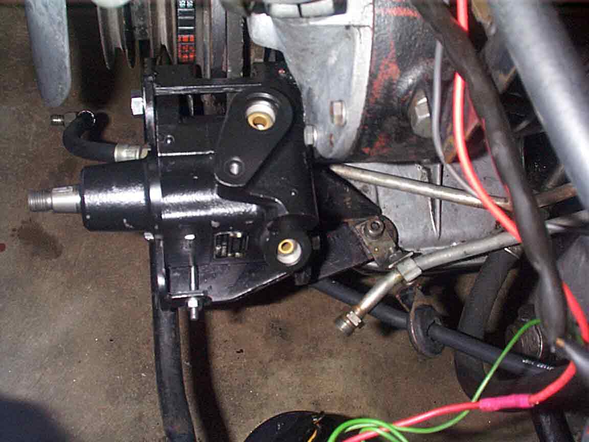

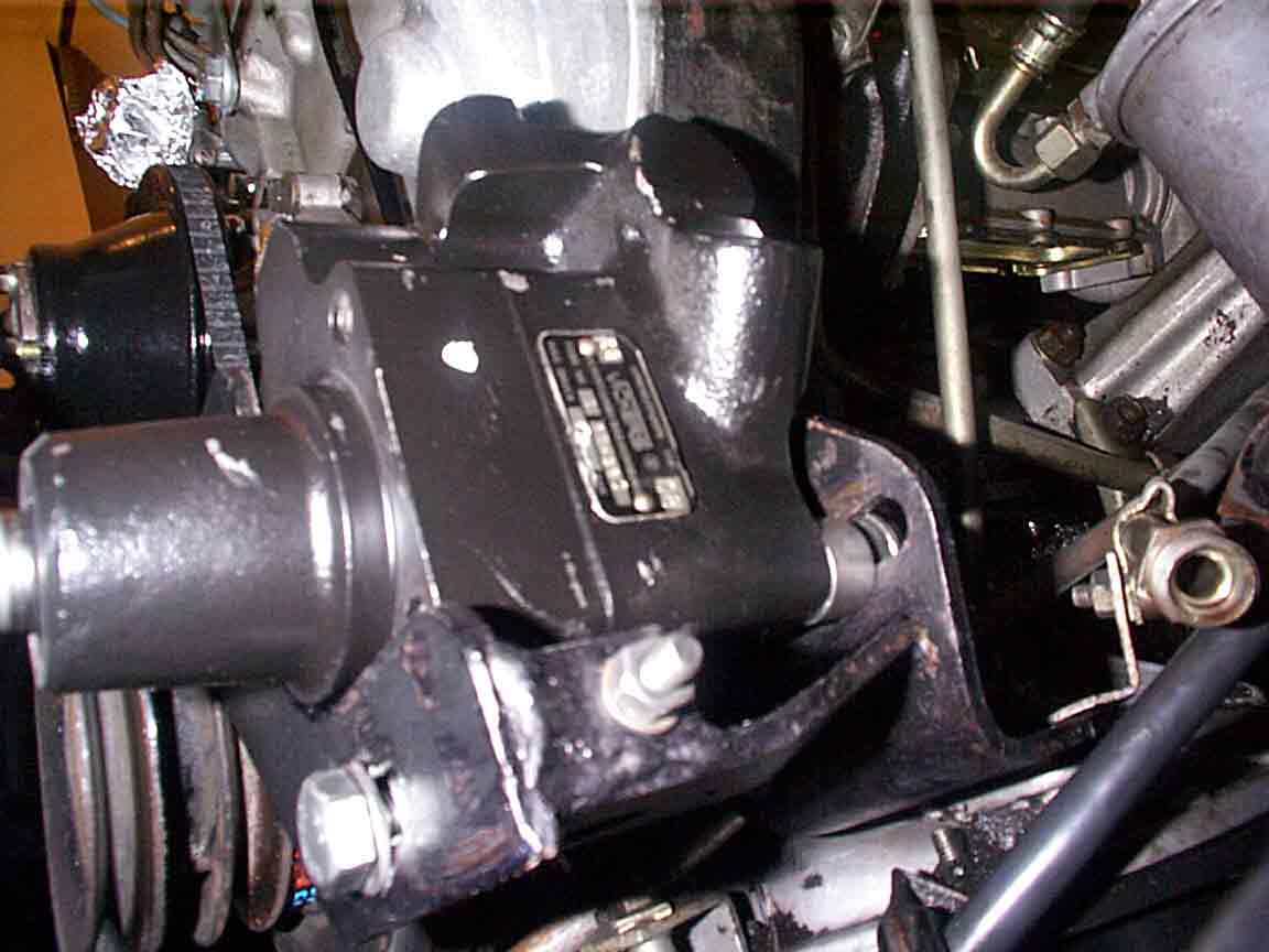

Here is a picture of my rebuilt power steering pump going in.
So far, so good.  Had to remove one of the rear bolts from the new/rebuilt pump (thanks Joe!) and use my existing longer bolt with spacer in its place.  Also carefully tapped out the old "key" from the old pump's shaft.  The new/rebuilt pump did not come with a new key for the shaft/pulley.
More to come...

Sounds like your making good progress. I did that job a few years ago.  The pump was groaning so I replaced it as you are.  That improved the pressure and caused the steering box to leak in the same place as yours.  Unfortunately I didn't know one could replace the o ring so I removed the box and rebuilt it. Live and learn.

Finally got the new/rebuilt PS pump fully installed, radiator back on and car back in operation.  It is amazing at how quiet the new pump is.  Even when I turn the wheels to their full lock positions, no noise.  What was also interesting is that no air bubbles came out when I bled the pump.
