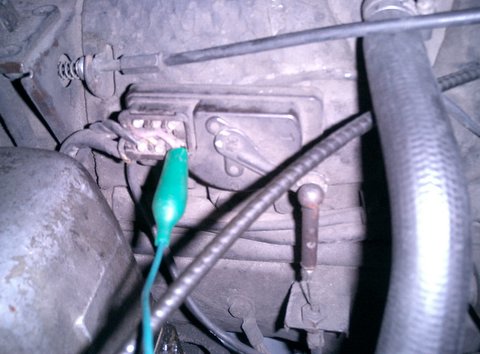

I had the idea of taking off the distributor cap and connecting my meter to the clip that connects to the points (other end to ground), since this clip also connects to the 7 pin under the battery.  It means measuring the dwell while cranking the engine with the cap off, but it's a heck of a lot easier.  I set the points at .012 inches, and the first time I measured the dwell it this way it came up 30 degrees, so it looks pretty good to me.  Here's a picture of my connection:

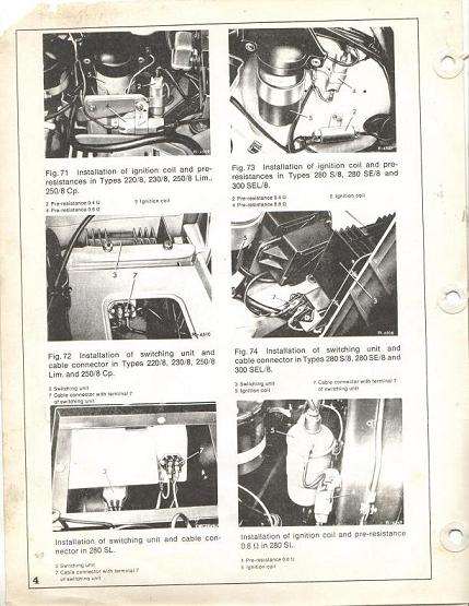

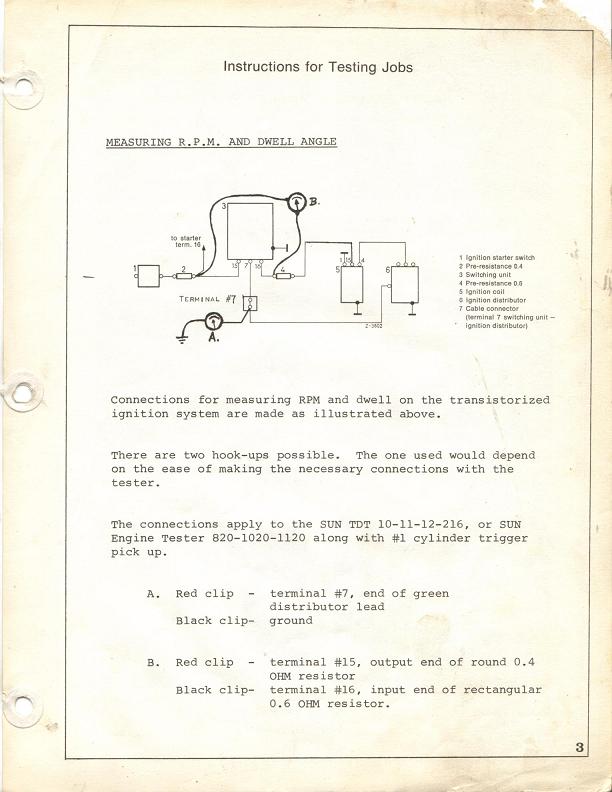

Here is some information not in the BBB. It was sent out in a factory service bulletin. It is for the factory transisorized ignitions.
b]Download Attachment: dwell1.jpg
56.16 KB
Download Attachment:[/b] dwell2.jpg
53.86 KB

Thanks, Joe.  Those diagrams that you posted are very informative.
I have a practical issue with the diagrams, however: the connections are difficult.  They want you to either (A) go under the battery and connect the meter to pin 7 (and ground) or else (B) connect the dwell meter to the ballast resistors; unfortunately, the inlet of the .6 ohm resistor is tough to get to.

By the way, here is a picture of where I connect a remote starter to get the points to the top of the cam -- it's to the right of the engine block as you face the firewall (the other end briefly connects to red + to crank the engine) :
I've been able to get it to exactly 40 degrees this way, and it starts quickly and drives great!
