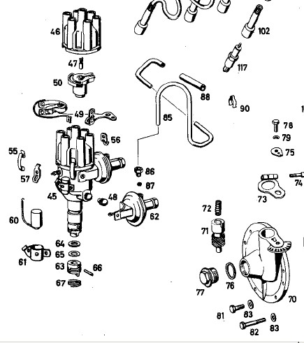

Yes, I guess the spring force is not that critical. We have discussed the purpose of the spring previously, I guess(?)  Anyway, what this spring does is counter the fact that the spiral cross shaft gear (that drives the distributor) will tend to lift the driving part (No 71 in diagram above) upwards in the play available; when one quickly changes engine rev's. This then alters your timing!

Is the spring being talked about #72 below?  I cannot recall seeing it when I had my distributor out.

I believe the answer to your question is yes.  The spring is not that easy to see.  When I removed my distributor,  gear #71 sort of popped up and I decided to take it out and see what it was all about.  This is when I learned about the orientation of the distributor base and this gear assembly.  I had no spring present in my engine so I added one.

Yes, this spring (#72)is often missing. It does prevent any up and down  movement of the distributor drive gear. Up and down movement of the gear would cause minor timing variations.
Caution, one should always be certain to push downward on the distributor after loosening it's  cinch  when adjusting  the timing, otherwise this little spring will push the distributor upward disengaging it from it's drive gear!
Thanks for scanning in the nice diagram Jim!
