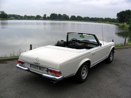

Pete a couple of photos attached.
Download Attachment: timpic.jpg
54.03 KB
Download Attachment: IMG_0566.JPG
67.88 KB

That's a beautiful car Rob.  The wheels make it look sportier and less luxury, especially with the top off like you have it.  Thanks for posting.
My wheelcovers are original but not perfect.  I'd rather spend the money on a new set of bundt wheels than on wheelcovers and then more for the paint.
Also I'm going to try them with the 185/14 tires and new Bilsteins as a first step.
