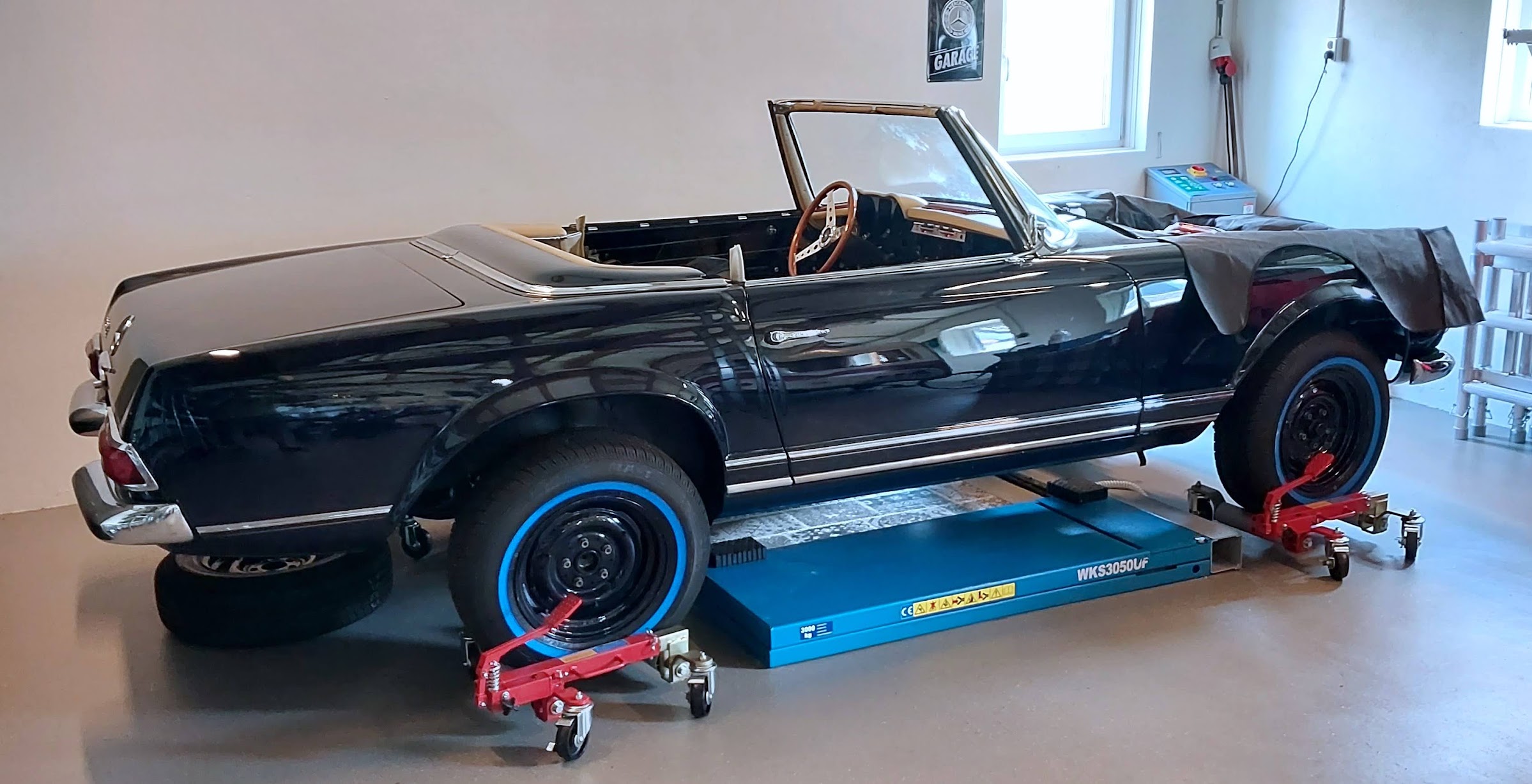

« Reply #263 on: May 29, 2025, 07:38:03 »
Real progression now!  ;D
