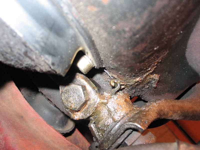

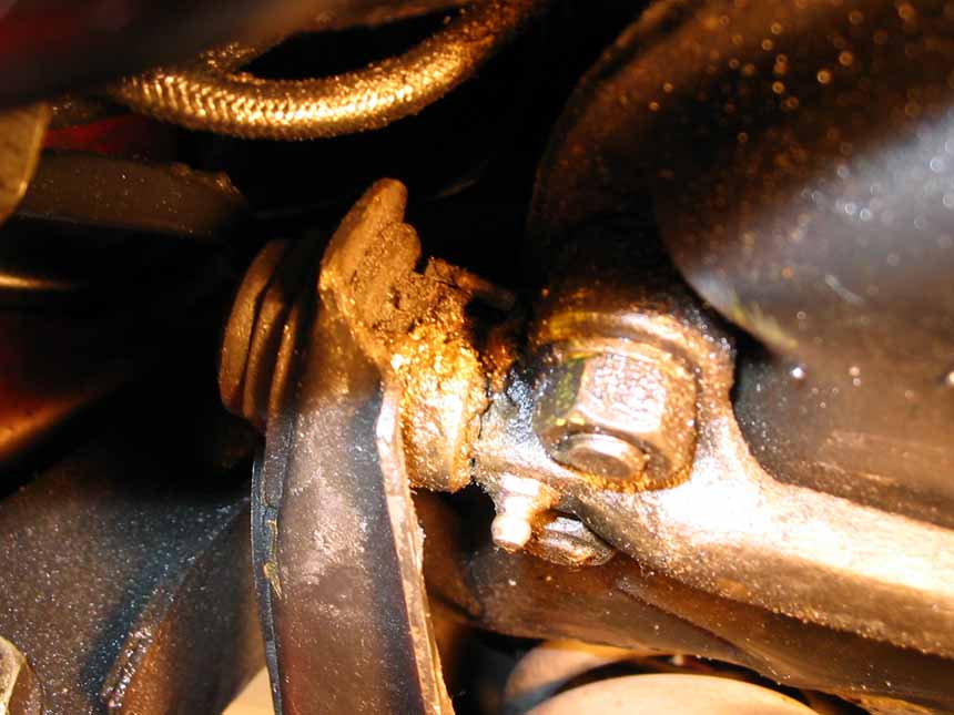

As part of my repair nightmare this weekend (see other post), I noticed the flexible rubber bushing sealing rings appeared damaged, on the front upper and lower control arms. All four rings, on both left and right sides seem the have the same problem - they seem split - as if they cover about 5/6 of the pivot arm.
Here's a couple of pictures of two of them:
Download Attachment: IMG0529.jpg
52.22 KB
Download Attachment: IMG0527.jpg
59.85 KB
I suspect these things should be intact, and cover the pivot arm all the way around, no?
Question: Can I replace these, one at a time, by supporting the vehicle and/or wheel, and just remove the Threaded bush (which has the grease nipple on it), install new seal, and reinstall the threaded bush???  Or, do I have to remove the entire control arm???

Hello William,
Yes these rings should be solid. They can be a real project to change. When you unscrew the threaded cap the tension from the spring will move the suspension a-arm out of alignment Making it very difficult to re-install the threaded fitting cap. Bob Possel just struggled through this job I believe.
I have an idea for a interum repair. Clean the grease off the joint, buy some new seals (they are inexpensive), cut them once so they can be installed, supper glue them back together, grease the suspension! Let us know if this works. Supper glue is a permenant joiner on rubber parts. It is used to  make rubber o-rings etc.
Replace the seals with solid ones someday when the suspension is apart!

BP ..... Removing the spring and lower control arm is easy.  I do not have the Haynes manual but I replaced my front springs this week without any difficulty.  Jack the car up high and set it on jack stands.  With a floor jack, lift the lower control arm to take tension off of the kingpin.  Remove the lower bushing (large bolt with the cotter keyed nut) then lower the jack to release the spring and lower control arm.  Installation is the reverse.  Check that the top of the spring seats correctly against the rubber bumper.  Threading the lower bushing can be tricky; first check that it will thread through both sides of the control arm (I need to squeeze the end to get the treads to align).  Jack the lower arm so that it aligns with the kingpin, insert the rubber bushings and reassemble.
I really would not worry about the seals as they appear in the pictures.  They just keep a little grease against the bushing so that it doesn't rust.  There appears to be plenty of grease so you should not be too concerned.
