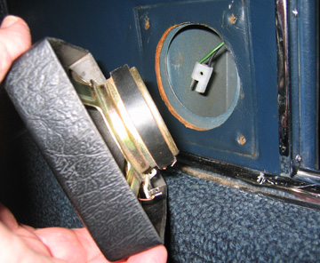

Dave,   I've recently sought out a solution (and Ed Cave has some good ideas...).
Here's the issue I've found.
First, new speakers have a larger magnet than the original floor speakers and the original hole does not accomodate the larger size without modification.   So, since I'm trying to keep appearances the same, I'm considering alternatives for speakers.    While I've seen good ideas on the forum, I've not found anything I'm excited about yet.
Anyone with new ideas?

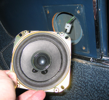

« Reply #15 on: April 29, 2005, 21:53:12 »
With a little modification to the speaker frame these Pioneer speakers fit nicely into both the housing and through the whole in the kit pannel.   Modification was to gind the frame down to fit the housing.

« Reply #17 on: April 30, 2005, 17:22:43 »
Dick, thanks for the pic.   I want to clarify that you actually cut the metal hole larger to accomodate the magnet, is this correct?
I was hoping to avoid a permanent modification to do this.   Do others have an opinion on this?

« Reply #18 on: April 30, 2005, 23:53:35 »
Hi..
No that is the original size of the hole.  The magnet part fits through without modification.  Only the Speaker frame was ground down to fit the  covers.
With the Europa II amp the sound is very good...
