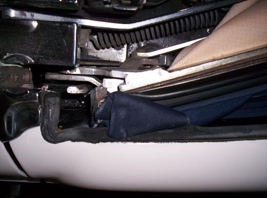

« Reply #14 on: April 07, 2005, 07:35:22 »
This topic has popped up frm time to time but, I have never seen a mention of the most obvious cause of wear and tear on our edges. As the top is lowered  the edges rub against the soft top case. On my car the case edge was rough and it was causing damage to my soft top. I used my handy dremel tool to smooth the soft top case edge and put some trustyduct tape over the metal. The duct tape is back and concealede by the soft top cover. This simple solution reduces abrasion as the top is raised and lowered.

Re: Soft-Top advice
« Reply #15 on: April 07, 2005, 08:46:05 »
Good insight Ted. I too have the duct tape on that area. It was very obvious when I replaced my topcase seal that the frame/top hit that area... The rubber immediately started getting chewed up.
Re: Soft-Top advice
« Reply #16 on: April 07, 2005, 09:16:11 »
This shows what we are talking about....
