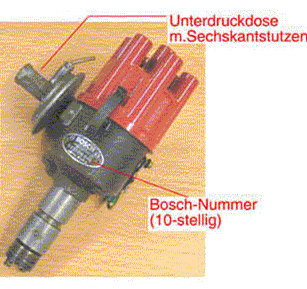

I just found out that my 051 distributor retards the ignition to much. How do I adjust it? Do I shorten or lengthen the connecting rod inside the distributor or do I adjust it on the bolt that sits at the end of the vacum unit (where the pointer saying "unterdruckdose" is pointing to)????

« Reply #1 on: April 05, 2005, 15:13:32 »
Mulrik,
you need to adjust the connecting rod inside the distributor.
The adjustment is pretty easy once you have the vacuum unit removed from the distributor.  I made a 1 degree change, and it seems to me that it took one full turn of the rod.  The hex bolt on the end of the vacuum unit is just a closing cap.
