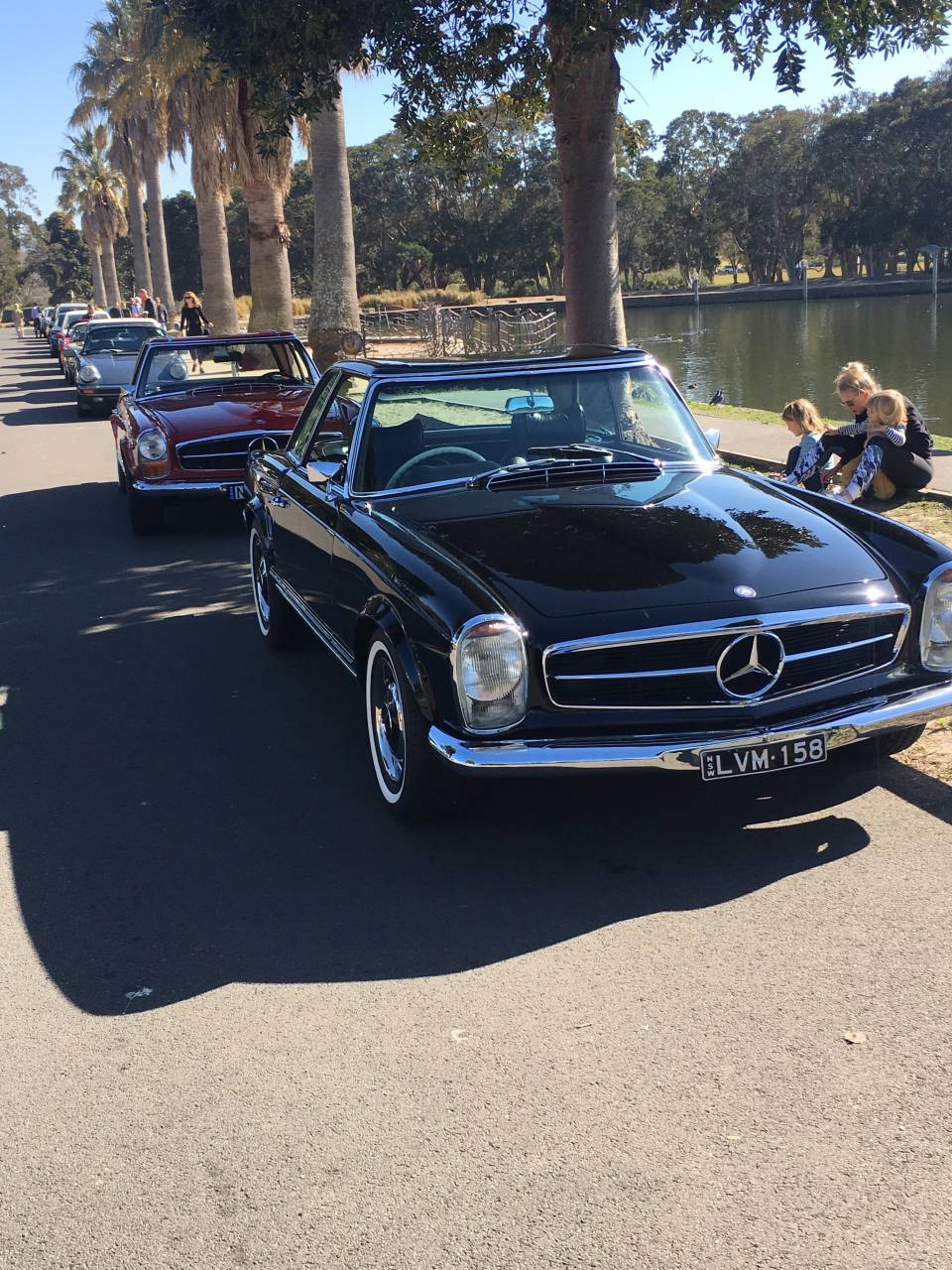

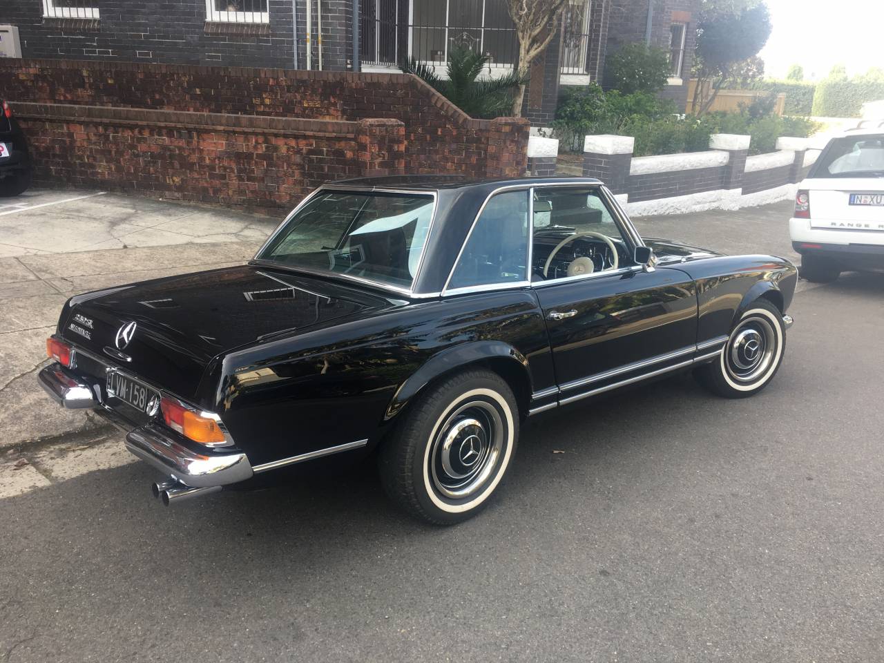

Here are some pics of my car - single stage black (MB code 040G)
Paint is approx 12 years old now
Franjo

franjo_66
  • Australia, NSW, Point Piper
  • Posts: 464
Some more pics
