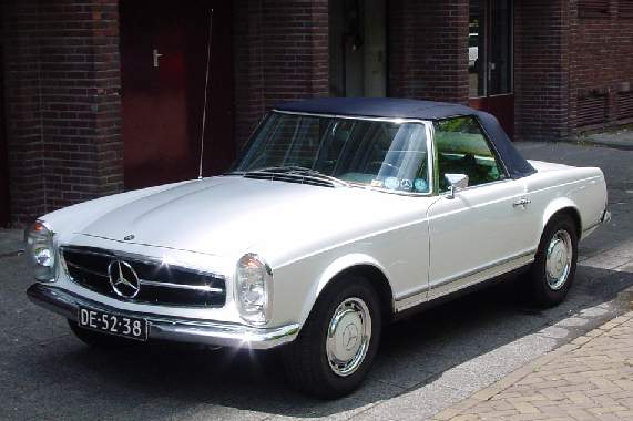

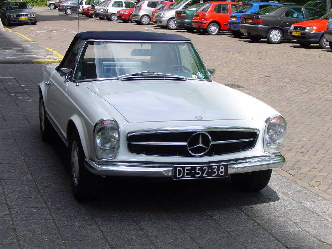

After my new paint job now over 3 years ago I had a coating put on ("ProTech"). Since then, all I've had to do is wash it with some of the manufacturer's shampoo and warm water a few times a year (no waxing or polishing), and it looks brand new today.
