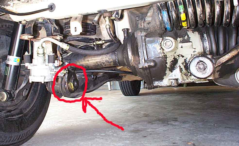

Please refer to the attached photo.  I took this prior to installing my new gas tank...
It looks like the nut on the trailing arm has a safety clip bent over the nut.  Is this correct?  If so, do I need to buy a new one before I start this work?  Or simply bend out of the way and then rebend over the nut when finished?

Re: Trailing Arm Bushings
« Reply #6 on: January 28, 2005, 13:07:38 »
Hi Bob,
I was able to bend the safety clip and reuse it just fine.
The trailing arms are on very tight. I think some sort of pneumatic socket is needed to remove the nuts. I used a 35mm socket. I had the file the nuts every so to get the socket to fit. For the outside bolt you need  to be a very shallow socket. The lower shock absorber bracket would not permit me to use the socket driver. I didn't have one so I ended up putting a pipe wrench with a cheater bar on the socket to remove this nut.
Removing the clip to release the old bushing can be done using a work bench vise and a home made spacer.  Let me know if you need any help.
