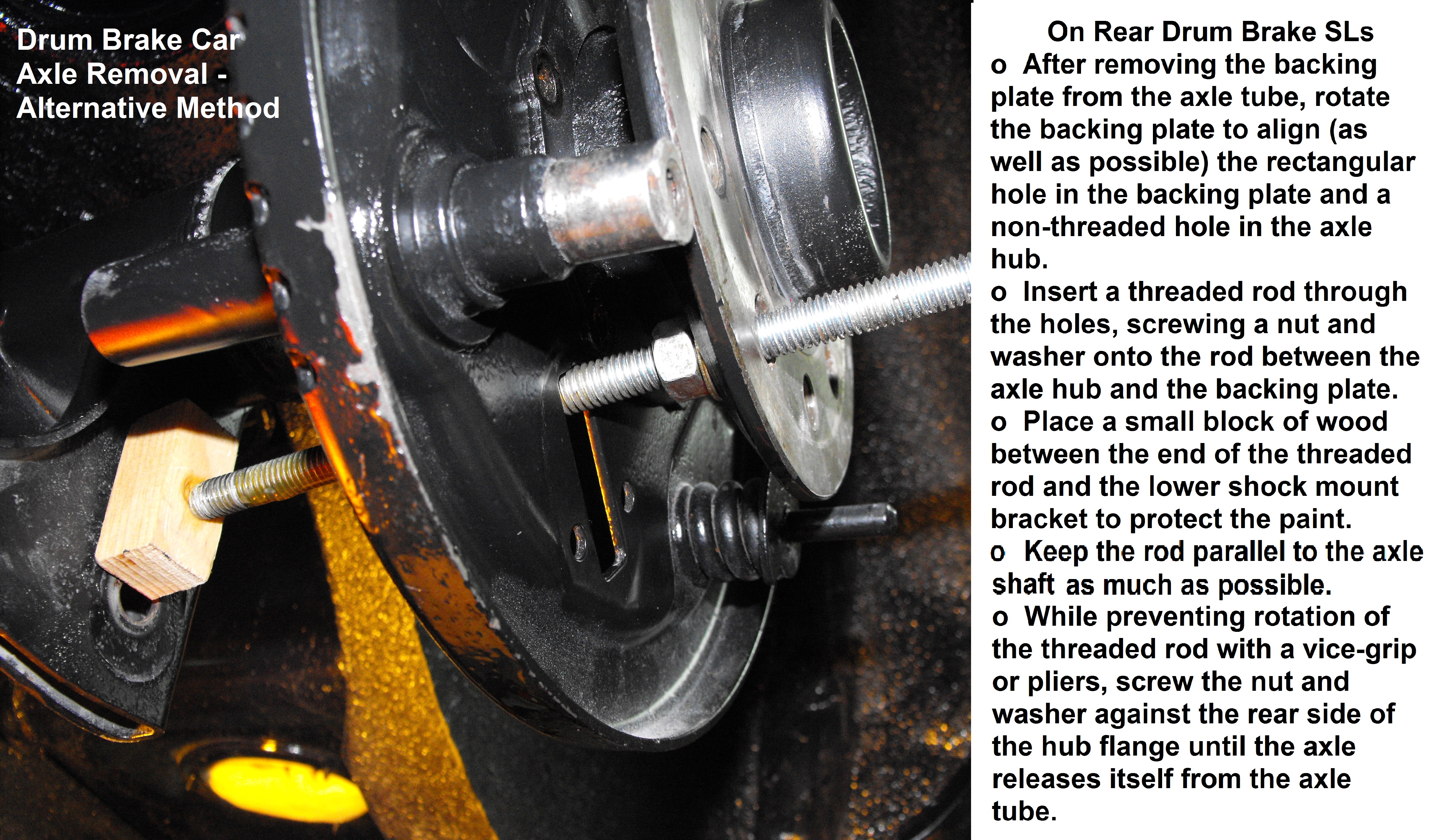

Maybe this helps:
64 retainer
outer side of the shoe
65 washer
66 spring
67 washer
70 cotter pin
If you follow this link and get towards the end/bottom of the bearing replacement process - you will see pictures of the part you are looking at, I think.
https://www.sl113.org/wiki/DriveShaft/RearWheelBearings
Pawel

« Reply #2 on: February 22, 2019, 20:04:59 »
Thank you for the help.
I'm aware of the order of the parts at the pin, but as you can see the ring is stuck at the pin.
And the spring is pre-tesioned, so how does it stay there?
