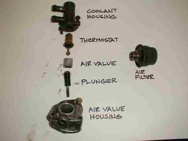

Hello ziggy,
The injection pump oil on the (M130) 280-SL engines circulates with the engine oil so it does not need changed as in the ear4lier w113 cars.
The "warm up device" on the injection pump can be checked by removing the small metal air filter canister on the back of it, and seeing if the passage closes as the engine warms up. Check this air filter to make sure it is clear also before re-installing.

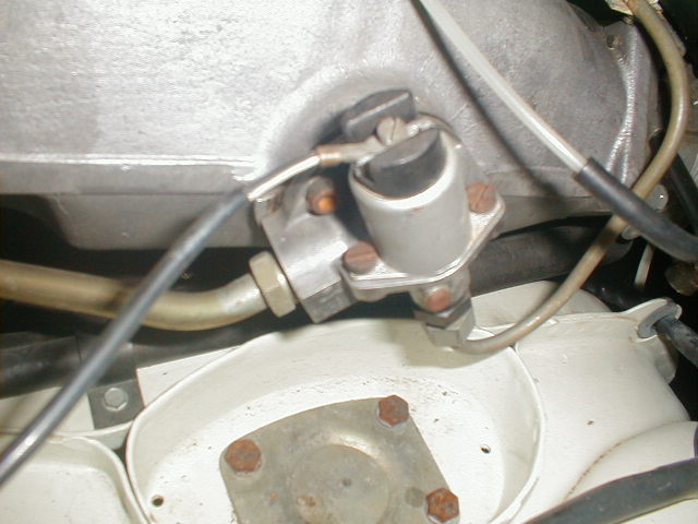

The "cold start solenoid" on the intake manifold should also be checked to make sure it is not leaking fuel into the engine.

The CVS is suspect for leak by and there is a simple test
 Remove small hex plug from side of  valve... turn key ON..[ energizing electric fuel pump].. NO fuel should come from plug port.
 The port is after the valve seat, so it sould only see fuel when cranking engine.
 Place towl near port..[ to catch fuel].. remove distributor wire, crank engine .. you will see fuel squirt, verifying CSV normal operation..
 Up/down rpms at idle are common complaint on leaking CSV as there is no control on fuel mixture.. not as noticeable at higher rpms.....

-checked the warm running device, seems to be ok high vacuum when cold and none when warm

I've tested the CSV now and it seems to work ok. I turned the idle screw 3 clicks richer and  that was a bit of an improvement when driving cold, no more misfires although it certainly wasn't running smoothly. When I started it again half warm when it fully warmed up it began misfiring and stumbling again however.
