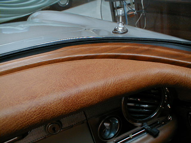

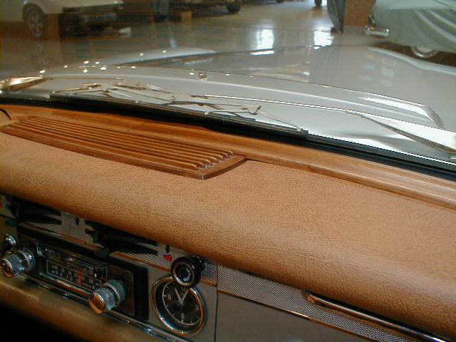

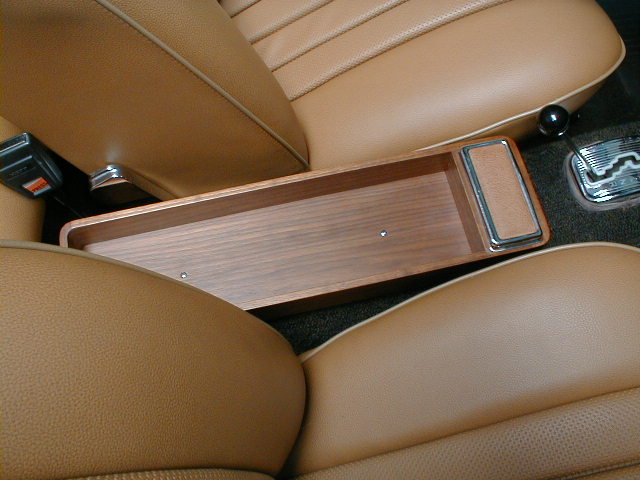

I use Heritage's wood components in my Pagoda restorations.  Here are some more photos of what they look like.
Download Attachment: dash2.jpg
57.34 KB
Download Attachment: dash4.jpg
60.82 KB
Download Attachment: box2.jpg
66.09 KB
