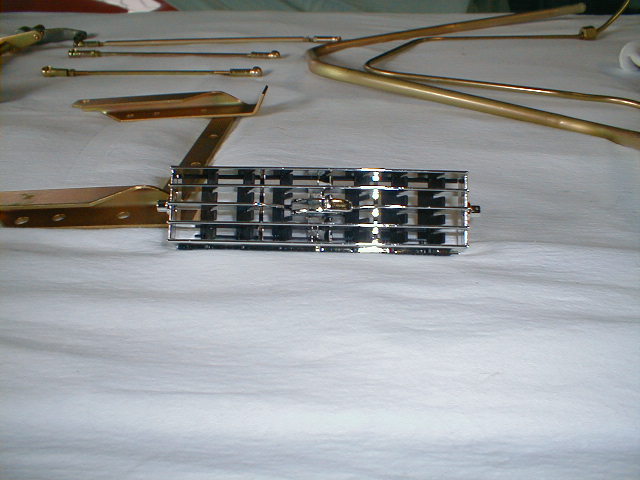

As has already been mentioned I used "Back in Time" to have Ed's vents "vacume metallized".  I understand this is the method that was used originally.  Other outfits somehow actually chrome plastic but "Back in Time" indicated that you wind up with clearance issues as the chrome process deposits more metal than the metalizing process.
   When dissasembling the vent we were not able to remove the center right-left black diffuser without possibly breaking it so it is now chrome(not really noticable inside the assembly).
   I will try to upload a photo of one of the vents.  If I can't get it to load I will have the photos up on my site eventually or maybe I could email one to another member and they can upload it for all to see.

« Reply #8 on: January 09, 2005, 20:55:31 »
Thanks Brian.  I really appreciated your time the other day.
Your photo looks great.  I will be speaking with "Back-in-Time" tomorrow.

« Reply #9 on: January 09, 2005, 21:19:35 »
Brian -- A little follow-up: I just played around with one of those Frigiking vents.  I see what you mean about being unable to disassemble it and that the black diffuser will therefore also have to be chromed.  But I wonder about the small, front & center finger tab...which is also black.  It would seem any thin vacuum plating here might easily wear away.  My guess is that a light pass over of the new chrome with a Drimel cloth might just return the finger tab back to its original black state.
