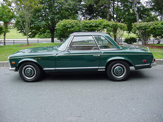

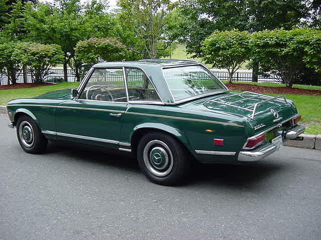

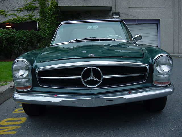

Please have a look at those photographs and tell me how is it possible that the hardtop is sitting so oddly. Can this be just because the top has not been tightened?
Also, the bonnet seems not to be very well aligned. Maybe not closed properly? Or something more serious.
This is a car I am thinking of byuing. I have not seen it in real and all I have are those photos.
Thanks in advance for any help

I wouldn't buy a car like this without looking at it person.  If you can't see what you are buying, best look elsewhere.  Only regret can come out of this.  Also understand that you are looking at a 35 year old car; it won't be possible no matter how many you look at to find one "perfect".  What level of 35 year old imperfection are you willing to put up with, and how can you be sure that anyone looking at this for you will have the same attitude?
The way the hard top is fitting looks a little peculiar, like it is tilted forward a bit.  Perhaps it was just laid in place and not locked down for the photo.
As for the bonnet, it looks ill fitting as well.  This could be the result of many things.  First, it may have been removed for some service and not reinstalled properly.  This is a known issue; it isn't always easy to get it to fit well particularly if you don't know what you are doing.
Second, and this is more important, is that these bonnets were hand fit to this hand built car.  They are all slightly different in size.  What this means is that a "used" or junkyard bonnet may not fit the same as the original.  So, if the car was in some kind of accident and a used bonnet were fitted, it could have some irregular fit issues.  Along those lines, the new bonnets (which run around $2,000 or more) are supplied oversized and are trimmed to fit the opening on each car when installed properly by a body man who knows what he is doing.  I had a junkyard bonnet and my restorer--a perfectionist--wouldn't work with it.

As I mentioned it could be that the hard top is not locked down properly, that it was just "laid in place" for the photo.  Most of these cars have a bit of a gap there, but on the one you show it does look tilted forward and the gap excessive.
My hard top is unrestored and sits in my basement; the car to me is a roadster and should be driven topless.  So I am not the best person to ask about this.  Some of our members leave their hard top on all the time, and it would be best to get some photos from the rest of the group.

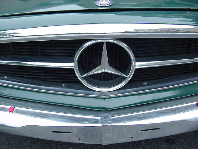

Looks like the hardtop isn't latched tightly. The chrome handle on the driver side isn't fully tightened. Perhaps that may explain the hardtop fit, but I can't be sure.
I agree with Mike on this car. It has a lot of red flags to my eye -- the worst one being the fit of the hood/bonnet. My first thought is a poorly repaired front end collision. Note how the grill and driver-side headlight assembly also don't fit properly,
Also, that front bumper looks like it was from a 280SL parts car judging by the holes on either side. Again, signs of a repair done "on the cheap."
Even the horizontal trim behind the rear wheels is installed at the wrong angle.
Here's an example of a 230SL that looks to have good panel fit and, to my eye, looks like it could be worth investigating further:
http://www.centralvalleyclassics.com/cars/Mercedes/65230SL/65230sl.html
Compare these 2 cars and you'll see a significant difference.

I did see the red screws on the top of the front bumper but I thought that they were a residue after some fog lights. Now I agree after seeing some US specs. 280SL's they are rather holed to fix the bumper guards.

I too would be very cautious about buying this car.  The bonnet alignment looks like it couldn't easily be corrected just by adjusting the hinges, and it's hard to understand why the hardtop fits as it does.  Those things are _heavy_, so even if the latches weren't fully latched, the top should fit fine.  It does look like the car may have been in an accident, possibly a bad one, and not repaired properly.

Let me ask you this -- what's good about this car? I see a lot of details that show a complete lack of regard for  decent standards of workmanship. And that's just the parts you can see -- imagine what's underneath that paint.
If you want a car you can re-paint inexpensively, at least start with a straight one.

To me this car car screams "Keep Searching"  This car can also be used as an example of what not to buy!
Personally I would keep up the search for a better car.  Remember that what you'ld spend on getting this one up to specs would probably buy you a very good driver.

If you ask for opinions here, you will surly get them!  Here are some observations not previously noted:
- Lower trim (mostly) missing on driver's side.  The small existing piece by rear wheel is rivited on, but should be clipped on(?) or affixed in a manner that does not show rivit or screw heads.
- Existing trim missing rubber insert.

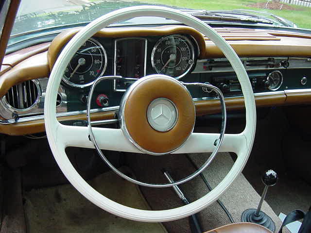

- Radio is modern replacement.
- Steering wheel is white, but stick shift knob is black.  Shouldn't they be the same?
- No rubber floor mats in foot wells.

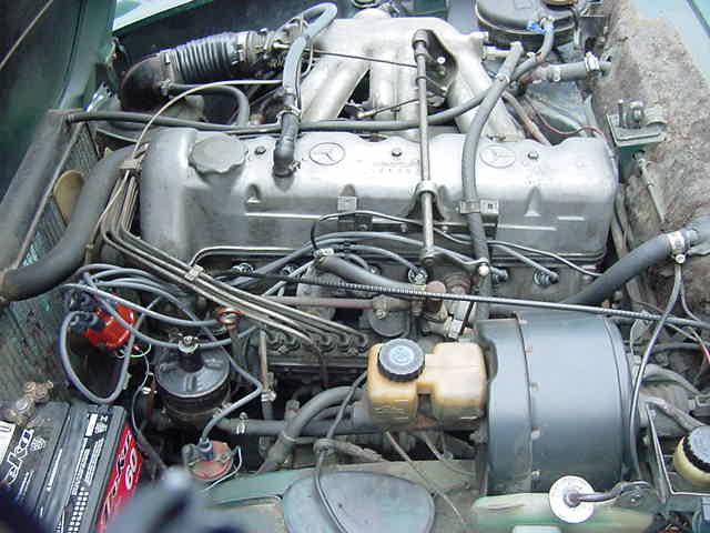

- Odd (non-original) valve cover breather tube leading back to intake manifold.
I would think it would be easy to find a good Pagoda in Europe, is there a reason you are shopping in the USA?
Also, you say you don't want to spend much to get a car.  Even with low labor rates in your country, it will cost a good bit of money to make a poorly maintained car into a reliable driver.  It's always smartest to buy the best quality car you can afford.  If you want a reliable driver and can't afford it now, then save more money and get it a year or two later.  Prices on these cars will go up, but not very quickly.

This car hass many obvious "issues". The nose - hood fit is terrible and indicates prior collision work. You can probably expect a lot of bondo covering up rust. If you go see this car, take an experienced 113 specialist with you. Don't let your emotions overcome your better judgement.

Is it really so that the color of the steering wheel matches the shift button?
Re: Newbie Question: What are the gaps caused by?
« Reply #16 on: January 10, 2005, 13:01:45 »
The shift knob should be the same color as the steering wheel. You sound like you have a good sense for shopping a classic. I can't believe there was no prior damage. The hood should line up perfectly with the nose panel. Very critical area. Look for the "ridges" on the inner edges of the headlight openings. They should continue past the ridges on the chrome headlight surrounds. Quite often when a nose panel is replaced, the ridges are gone and the reinforcement behind the panel just gets improperly straightened. The hood will never line up properly when this is done.
