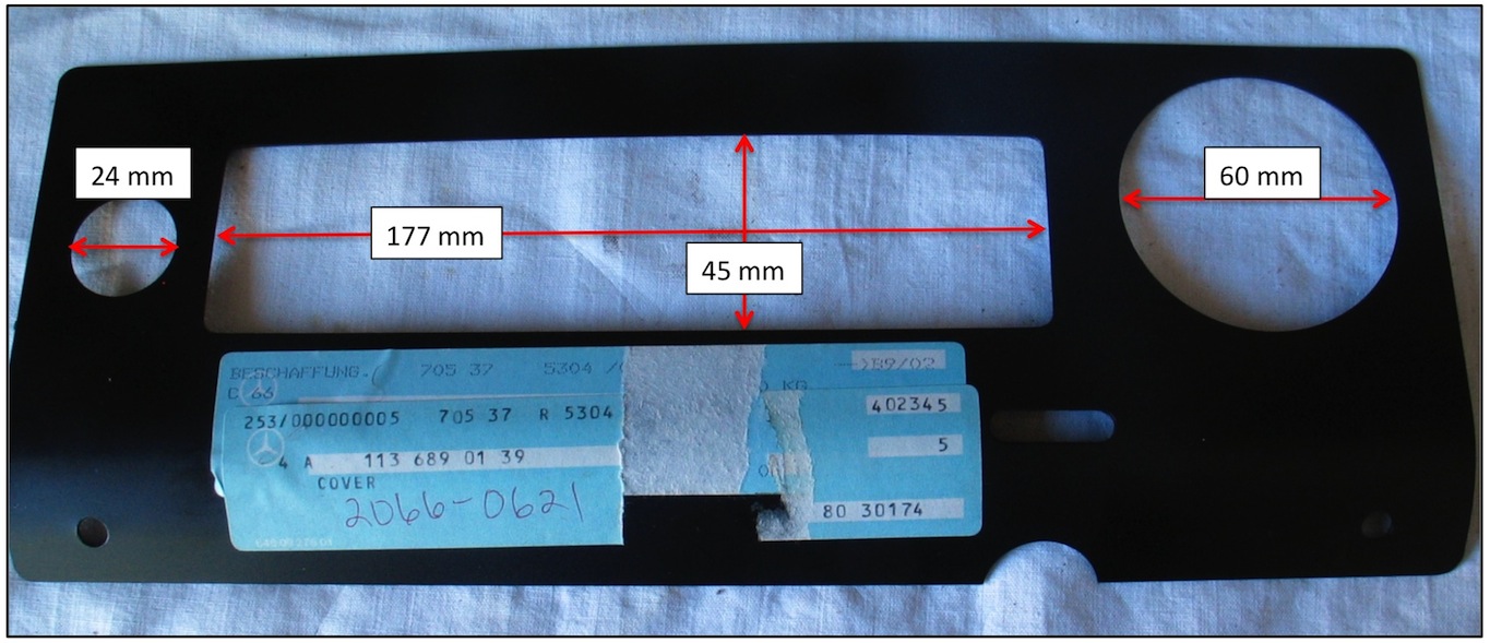

The Tech Manual describes a different opening for the 230/250's than the 280.
...which is unfortunately incorrect.  The early 250 SL has the same opening as the 230 SL.  The late 250 SL has the same opening as the 280 SL.  I think both panels are available as replacement parts from one of the parts repro websites.

I disagree. The text in the technical manual is absolutely correct:
"The W 113 cars have two different cut-outs for the radio in the dashboards. The rectangular dash cut-out in 230SL and early 250SL cars (until VIN 2580) is covered by a separate metal sheet that has a smaller rectangular cut-out for the radio and two round ones for the cigarette lighter and the clock.
All 280SL models lack this cover sheet and the rectangular cut-out in the dash has the standard DIN dimensions (180 mm x 55 mm) for radios."
That's not what I said.  I'm in agreement with the technical manual.  I'm not in agreement with:
...as this suggests that all 250s were small openings....
