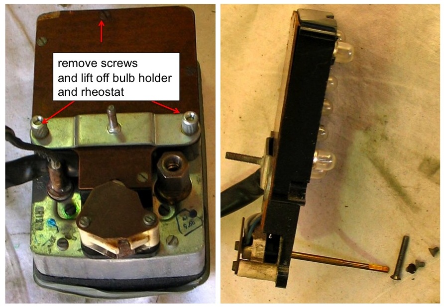

Hello Alfred,
that photo of the "inside" of the central instrument cluster is extremely helpful! Especially because I've never seen one opened up. But still there are questions. . . For one thing, you've labelled the red LED as blue. 1 point for me if I figured this out, 1 point for you if it really is supposed to be blue  :o
Are the green LEDs used for turn signal indicators bright enough to be seen in daylight? I find my stock turn signal indicators are almost invisible in daylight.
Did you hang on to the part numbers if you ordered these LEDs from www.superbrightleds.com ? Why not make a list? If you didn't, I'll scour their website and see if I can figure which one is which.
The low-fuel lamp is just a regular 2W bulb? So the red colour comes from a lens in front of the lamp? This one I probably would not want to make brighter.

Hi Peter, 1:nil for you!
I colored the borders and arrow red but mistyped the text, it should read "red", not 'blue".
--Corrected April 6, 2017!
The turn signal indicators are really bright, especially when it is dark, and I am not sure whether I should replace them with the 1-LED bulbs.
I do have a list of all the part numbers - including LEDs for other locations that I plan to put into the technical manual. I replaced the Festoon bulbs in the glove box, license plate illumination, and shifter console (for automatic 280SLs) also. Can you believe that they all have different lengths?!
And yes, the fuel warning light is a regular 2W, there is a red filter inside the housing.

Regarding accessing the bulbs in the center cluster, and referring to your picture ( and using the pictures at http://www.sl113.org/wiki/pmwiki.php?n=Electrical.Temperature ), how is the frame/glass part separated from the part holding the bulbs? I see that both the temp and oil gauges are removed first.

Hi Andy,
you need to unscrew the back as described here:
then you just lift the bulb holder together with the rheostat off. No need to remove the Bakelite cover or any other screws.
If your capillary to the temperature gauge is original, that is has not been repaired and shortened, thyen you should be able to pull the unit into the cabin far enough to remove individual parts from the cluster without unscrewing the temp sensor on the engine block.
Haven't had a chance to add all of this to the manual because of an upcoming trip to Europe.

how do you remove the dimmer knob from the shaft

the dimmer knob is not removed from the shaft, rather the shaft is pulled back out of the knob. You do this by removing the back of the center cluster as described above. The knob remains on the glass. When you reassemble, be sure that the shaft lines back up with the knob. The glass could break if it is not when the back of the cluster is screwed back down.
