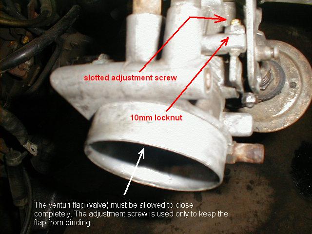

I think a lot of us are confused. I assume you are talking about the large slotted air screw at the intake manifold.
My first guess is that the intake stop screw at the venturi is improperly adjusted. If it is holding the butterfly open at idle , you are leaking so much air into the engine, the air screw adjustment will make no difference.
The small slotted screw with the 10mm lock nut at the venturi (intake flap) is often mistakingly used for idle adjustment. This is factory set. The venturi flap (valve) must be allowed to close completely then the small slotted screw is used to just keep the flap from binding. It is then locked down with the 10mm nut. Adjust the linkage rods back to specs.
Check out the photo below.
Download Attachment: M130 Intake Venturi with text.JPG
53.6 KB
 Keep us up to date.

Thanks for the suggestions, just to be clear I am indeed talking about the large screw at the intake manifold.

Then I reckon you should follow Joes advice, followed by A Daltons !
I've had similar issues and this is the route I went with success!
