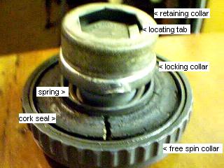

I have a good second hand MB locking fuel cap from a “sedan”, so it is NOT chromed at this stage.
How do I get the tumbler mechanism off the body to have it re-keyed to suit my car and also have the free spinning collar chromed?
I have removed the spring, spring collar etc.
I will replace the cork seal at the same time.
See attached pics.

On your 2nd picture with removed cork gasket, you can see one of the two little holes. Underneath one of it it a little metal plate which needs to be moved to one side with a stiff needle or sharp nail. Then you can pull off the upper non-chromed cap from the heavy main lower body which goes into the fuel-filler neck. Everything else will be straight forward.
The best is to dissassemble the gas-cap unit in a large cardboard box or pan so that you won't loose any of the little parts.
Then you need to remove one retaining ring/spring in order to remove the lock cylinder.

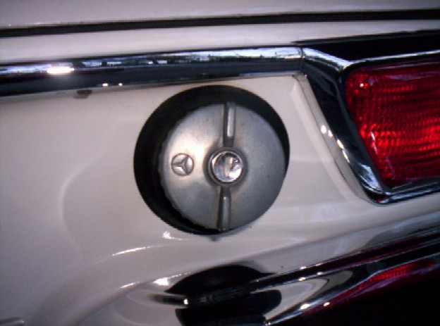

While on the subject of fuel caps, I have always wondered why mine is different than most. I know the chrome version has been called the official 113 cap. Looking at Bob's 114 version, I see mine is still quite different. -- just wondered if anyone has seen my style before?
Download Attachment: 63gascap.jpg

I found that little hole and removed the collar quite easily.
I think I will lurk on eBay.de and look for those chromed covers.

Hello James,
Yours looks like a 114 (& 115) gas cap.
What kind of key do you have for that one?
It's certainly not the same as for the doors
(T = Tueren und Tank, doors and fuel filler cap).
(Magdeburg, Germany)

I was hopeful it was "an very early" thing... The original key is a large rubber handled two sided Ymos. No, it does not even come close to the door keys.
The main difference I see from 113 caps is lack of chrome and grippy wings to turn. Thanks.

unfortunately not, I am sorry. Yours looks exactly like mine which I got for the 114 sedan. The key you describe is a typical 114/115/108/late 113 key - just a /8-key.
Very early 230ies had exactly the same fuel filler cap as the others, I have an example for that, it's the 000 471 20 30 which is still available from new. Only late 280ies (from VIN 10000 something) have a slightly different lock (but only lock) because they have one key-for-all. These cars have the same key like yours.
Don't feel sad about it; you have a nice one from MB. Definitely better than one of these uggly chromed or non-chromed aftermarket parts. And still, yours looks very classic with the bare metal surface. If I were you, I would keep it.
All the best,
(fuel filler cap collector)

Can someone please tell me where this gas cap of mine - shown in the attached photograph - came from? Is it maybe original? It is marked "Huf" and "ohne Lüftung" on the inside.
Download Attachment: GasCap.JPG
84.34 KB

Yours looks original, but the finish is very bad.  I don't know if your chrome is gone or if it originally had a matte finish.  Does your cap spin freely after being locked?
Yes, when locked the top spins freely. I have since painted it, using aluminum paint, but it appears that it was never chrome plated. The key for it, and there was only one, is marked "Huf" and has the MB top. It is not the same key that fits the doors. Those locks have been replaced to match the ignition key. Like someone said: When it is an old car, it's history is often unkown. Thanks for your help.

Your fuel filler cap looks nice but isn't original too but one from a sedan. Arthur's is correct.
The owner's manual shows how the key should look like.
The YMOS (chromed) is original, all others not.
I am sorry to say so ... Never mind.
