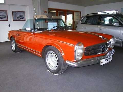

........these "Bundtcake" wheels were a factory fit option from 1968, and as such are correct options for some late 113's. They were also on the W108/109/111 as options and pre-date the introduction of the 107 series SL's.
To my eyes Minilites/Mags/Slots/Wires just wouldn't look right on a 113.
See Hausers photo below for e.g of the "Bundtcake".
http://www.sl113.org/forums/uploaded/hauser/200493094340_280with%2015inch%20wheels.jpg
These are actually a 15" version, as used on the 600 and hence very rare, but dont they look fantastic !!

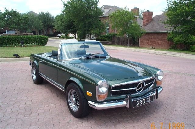

If you're looking for an ultimate 60's early 70's look...  then this just might just do the trick!
Download Attachment: green1.jpg

THose are the ones I mean re Mercedes originals [:p]
Were they 15" rims or did they come in 14" too, just asking as I would have to do the plus 1 thing re tyre aspect ratios to keep the speedometer readings correct

These MB wheels are most commonly found in 14".  According to Ben's statement, the 15" are hard to find.
There is a 14" alloy wheel that will accept the later one-piece MB hub caps.  Tom Sargeant has these.  This gives you the performance of a light weight wheel while maintaining an original MB look.  Plus, one-piece hub caps are still available brand new.

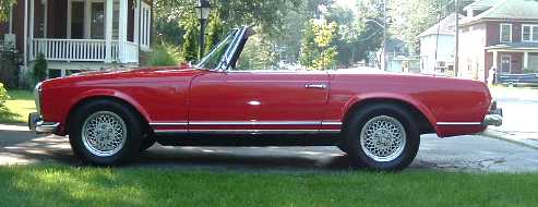

for what it's worth, here are pictures of my bucket of bolts with rims from approx. 1990 I believe - you be the judge as to the looks
Download Attachment: cedesback.jpg
8.55 KB
Download Attachment: cedeside.jpg
17.77 KB
65' 230SL

Hammerhead,
Your car looks good because you take care of it.
 For regular driving where a car doesn't get cleaned or washed every time it's driven you will find the painted rims will hold up much better.
