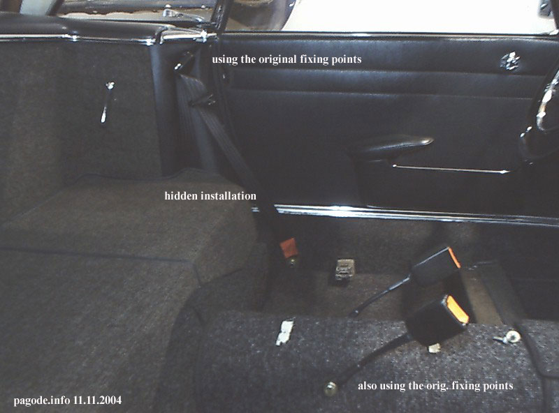

The question I have is with regards to the length of the buckle/receiver.  I do not want it to "stick out" to high above the seat.
I found this pic on our site --it looks like the buckle is longer than 6 inches http://www.sl113.org/forums/uploaded/pagode.info/2004111141755_seat%20belts.jpg
What would the 6 inch receiver be too short?

What you need is a buckle with a flexible cable or webbing. The buckle in your link is rigid and wont mount correctly to the holes in the trans hump. They are angled inwards twards the console. As far as length, you should measure from the mounting hole while the seat is in your prefered driving position. The further up the seat is, the longer the buckle will need to be. You dont want it so long that it buckles across your abdomen. Hope that makes sense.

A 6 inch buckle receiver should do just fine.
However, as Tyler just mentioned, a flexible cable is much more recommended. :)
Or ... if yours is stiff, get it bended and a bit angulated towards the seat cushion.
Mine are 22 cm (= 8.6 inches) long, and I personally find them a bit too long. But they're flexible and that is definitely a plus.

I bought these retractable 3-point belts in the photo on our web site from the German vendor (pagode.info) and they did not stick out too far. Once you have the seat in you'll see that they need to be higher than the seat cushion. They are not completely rigid but a bit flexible and the angle (about 45 degree) is adjustable. How far they stick out depends on the angle of the receiver whip, forward or backward position of the seat, that is, the available space, and what the person in the seat prefers. See photo showing two positions.
The optimal length of the receiver buckle depends of course on your frame size. The ones shown might be too short for a 350 pound defensive tackle!  ;)
I would not buy the ones with a short flexible webbing from the vendor in your other link because you'll constantly search between the tunnel and the seat for them. If you prefer the softer webbing then go with the original much longer 3-point static Kangol belts
