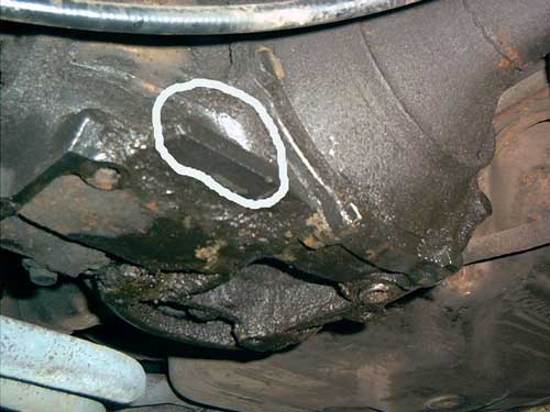

A Comment about the axle,
I don’t know if the axle is the original one because I looked for the axle ratio and the flat surface where it is supposed to be has been ground clean.
Is it possible that the number is located elsewhere? This is where I looked, see borrowed pic below
If not, then is the axle a replacement and how can I determine the ratio?

Download Attachment: Axle_Ratio Location.jpg

The ratio is stamped.  You may have to dig out the grime that's filled the stamped numbers.  Also, that's not where my axle ratio is stamped.  Mine's in the rear of the diff. housing on a flat half-circle surface.  The location depends on the age of the diff., mine's older so it's on the back.

I will have a look because my car is an early 250sl with lots of similar things to the 230sl.
Is it stamped on the axle left side or right side housing?
