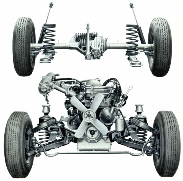

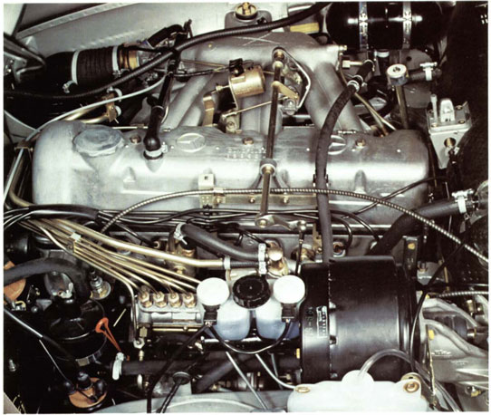

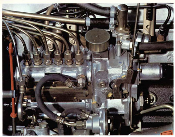

Hi Dan (and "Bpossel", who also asked for it),
I found these two pictures in the original 280 SL brochures (engine and injection), and another interesting picture in the 230 SL brochure: engine and suspension of both axles.
Download Attachment: 280SLbro.jpg
78.44 KB
Download Attachment: 280SLinj.jpg
78.73 KB
Download Attachment: 230SLaxl.jpg
78.13 KB
Regards
Albert de la Torre Chavalera
Barcelona (Catalunya/Spain)

« Reply #32 on: August 27, 2004, 04:56:50 »
Love the picture of the suspension Albert has posted!
Check out the wonderful crossply tyres  :D  Bias ply in US speak
Guess that would spark a "handling" debate
Cheers
