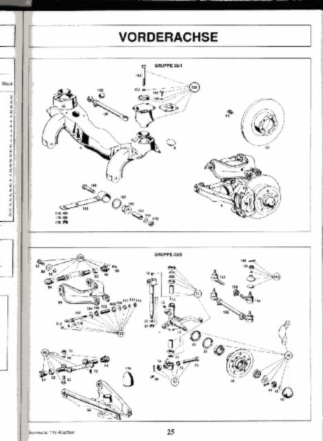

Next time try using your local MB dealer. They're not all as bad as cracked up to be, and common or garden parts are reasonable priced + they are the correct tensile strength.
Download Attachment: Fsus1.jpg
42.14 KB
14mm nut is bottom left corner, top picture (Sorry,don't know how to post bigger pic). Part # 308673 014001. Price 1.06 euro!!

Hi Naj, I did and no luck at any MB dealer the part is not even
shown on the microfish system anymore only the bushes and brackets
are shown not even Jackson could help you know the dealer in the south
coast who is a 113 supplier.
