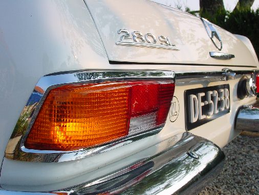

Here's the car in full glory:

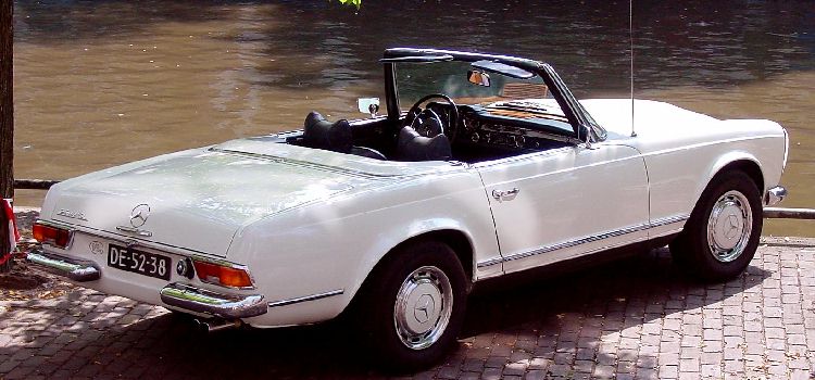

and one before the repaint:

Hey Cees,
Where did you get the neat chrome covers for the holes that are used to mount the bumper guards?

That's my cheap Dutch nature. Instead of having the holes in the bumpers welded shut, then rechrome them, I decided that, with simple antenna caps (that's how the auto shop I bought them at called them) I would achieve almost the same effect. The are chromed plastic (no discernible difference with chromed metal), have a small black plastic washer at the bottom and attach via a plastic nut that you tighten by hand from inside the bumper. They come in various sizes and are very cheap. I did the same with the front bumpers. I'm sure they can be found at any auto parts store, and probably even at places like Eckerd Drugs, K-Mart etc carry them.

Just got rid of my aftermarket bumper guards and followed your excellent suddegstion w/ antenna caps. Thanks!
