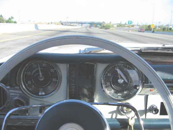

Hi again - - - I guess I left out a few details?
The conversion constant  with the 3.27 differential is 1.15 . - - Because I did not change the speedo gearing the indicated road speed is about 60MPH  while the true and calculated road speed is 69 MPH @ 3400 RPM.
Regards, Larry in CA
