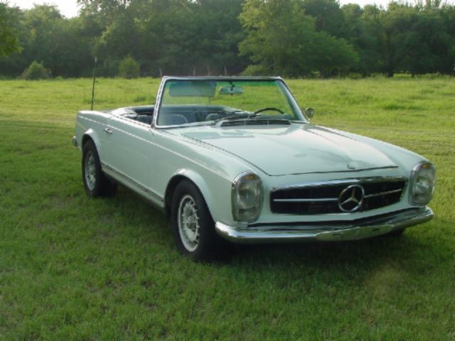

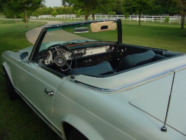

Trying to post a picture.

Hey the car looks great !
In fact its a mirror imgage of my own, same colour ,same wheels and in fact I have no front number plate either !!
