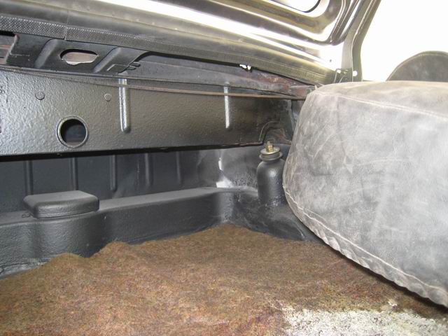

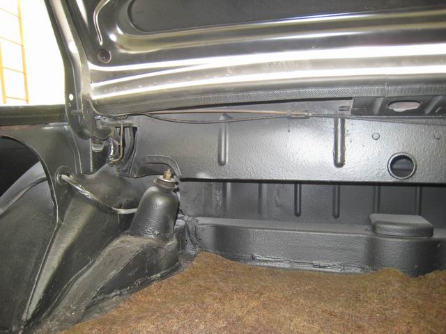

Yes, the soft top lid stays open and the tension it needs to close seems adequate (the trunk lid is much heavier so if it had the same load it probably would be too much).
I do not think the car was baked. They probably used a different technology without heat. But anyway, there are no plastic parts near the bars. Should they?
There are just the two struts both anchored on the right side in the in the trunk lid hinge and then in the middle there is a metal anchoring point on the "firewall".  On the left side they sit on the combined hinges of the soft top lid and decklid.
Walt, was it a joke with the paint being too heavy? [:0]
Can the bars be easily removed by one man? Any tips or howtos?
Download Attachment: Resize of IMG_0781.jpg
64.35 KB
Download Attachment: Resize of IMG_0780.jpg
62.09 KB
P.S. On the second photo I have tried a different way of installing the bars on the left side. But this did not work. Now both bars sit on the soft top hinge again, one in the groove, one above it.
