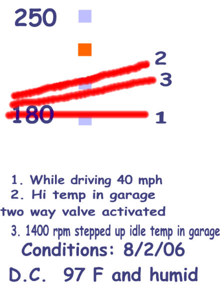

I've been looking at the MB instructions for improving cooling via a bypass kit that utilizes the thermo time switch opening in the head to recycle hot water out and into the radiator.  On cylinder to the front of this opening is the heater core hose port in the head.  You may have turned your heater on during very hot days to cycle hot water through the heater core and reduce engine temps.  After reading a post from someone else I decided to bypass the heater core entirely by connecting removing hoses from the heater core and connecting them together.  This seams to have improved the overall cooling of the engine quite nicely.  It is very hot in DC these days and I took a ride in the heat today and have recorded the results in the attached image.  This is preliminary.  I have ordered two radiator hose tee fittings.  I have plans to install the tee fittings in the heater hoses and route hot head water on a full time basis around the heater core.  When heat is needed in the cabin I'll open the heater core valve and see is sufficient hot water will flow though the heater core to warm the cabin.  A backup plan may involve using one tee in the heater hose leaving the head and adding a second tee in the lower radiator hose insted of the output heater hose.  Connecting the head output directly to the lower radiator hose is similar to the Mb instructions and may improve cooloing a little more.
Download Attachment: DC temp.jpg
39.34 KB

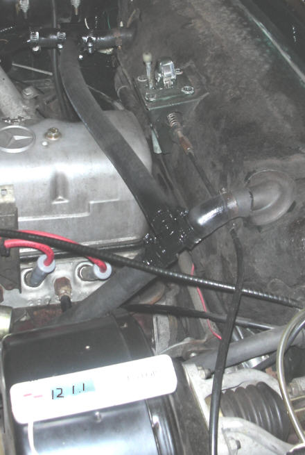

T fittings arrived and have been installed.  It's hot again in DC, around 95F.  Here are a couple of pics which show the temp gauge and bypass hose kit. The temp in the engine compartment was about 121F when I took these pics. Engine temperature has been reduced significantly.  Turned on the heater valve and received plenty of heat in the cabin.  It's hot outside so a better test will be taken in the winter sometime to see if heating has been negatively effected.
Download Attachment: heater hose 1a.jpg
32.84 KB

Just to pipe in with another case:  I've been driving my 250SL all week to work, as my 560SL is in the shop.  I don't have A/C (of all weeks for the 560SL to act up!) and it's been in the high 90's in Atlanta.  When I leave the office at 5PM, I typically drive down the freeway at 80 MPH and come to a near stand still when I hit Midtown.  For the next 10 - 15 minutes I am moving at 5-10 MPH.  Even in this heat, my car doesn't quite reach to next bar above 180.  The radiator hasn't been recored since 1978.  I have a container of Wet Wetter and have been too forgetful to add it.
Sounds like the emissions of the later 280SLs may be the culprit.  I met a couple with a late '70 280SL and they complained of the overheating at idle too.
I hope you come up with the right solution!
