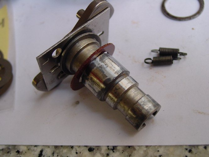

I imagine the cam is a major part of the distributor so did you have to replace the distributor or was it rebuildable?

The shaft comes out completely and so can be replaced in its entirety, or either of the two pieces that compose it can be replaced. It runs in two replacable bushings that are pressed inside the distributor housing. Here's a photo of the top half of the shaft, showing the cam part and, at the bottom of the photo, at the end of the shaft you can see where the little felt pad goes that should be oiled at specified intervals:

My distributor was rebuildable. Dan just replaced the cam section, as shown in Cees' photo, with a good used part.  I noticed immediately that the timing marks are much more steady now when viewed with a timing light, especially at 3000 rpm.  Hopefully the points will last longer, too.
