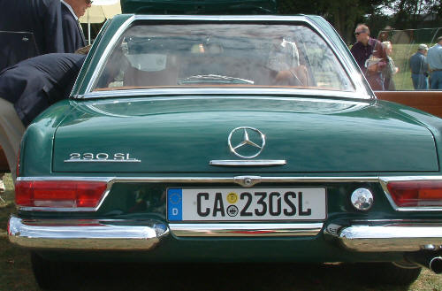

I do not a U.S. version 280SL and I do not have this feature/trim.  But you have peaked my interest on the look of such an item. Does anyone have a picture of what you are discussing, I for one would like to see it.
Jim
Re: Polished trim strip under rear license plate
« Reply #6 on: August 19, 2010, 04:09:15 »
Here is a shot of it -- not too close up but you can see the idea I think...
« Reply #7 on: August 19, 2010, 04:12:18 »
« Reply #8 on: August 19, 2010, 04:15:56 »
Here's one more... easier on the eyes! :o
« Reply #9 on: August 19, 2010, 04:19:35 »
I see, I get the idea, but it is interesting how different the chrome pieces appear to be in the pictures of the two cars shared by James Huber and Alfred (66 Blue).
It almost looks like an after market accessory trim.
Jim
« Reply #10 on: August 19, 2010, 04:43:13 »
Oh no! That was always in the original design by Paul Bracq.
It only looks like an after market accessory when you put a license plate over it instead of above it.

« Reply #11 on: August 19, 2010, 17:03:06 »
Also, Gugel's car and chrome is spectacularly bright and well-preserved. My strip seems to have turned to a matte not-so-bright aluminum. Cannot say it did not start as bright chrome.

« Reply #12 on: August 19, 2010, 19:19:14 »
Here's a fresh one  :D

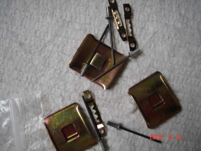

By the way, could someone explain how to remove this strip, without damaging it?
thanks,
Didier.
  • Posts: 4767
« Reply #22 on: February 18, 2011, 01:36:35 »
The strip has square plates on the back with a catch that hooks into retaining clips that are riveted to the chassis.
This photo shows the parts:
http://www.sl113.org/forums/uploaded/eryck/200561510158_attachment.jpg
More is described here: http://www.sl113.org/forums/index.php?topic=3586
« Reply #23 on: February 18, 2011, 03:36:36 »
Alfred's picture shows the clips. The valence lifts up and off of them. Just carefully worked upward and they pop off.
« Reply #24 on: February 20, 2011, 14:49:35 »
Yes!
Gently push it upwards and it comes apart. I didn't understand from the previous posts how it was installed on the car, Here's a picture that may help (just in case some other pagoda owner would be as stupid as I am! ;D)
Thank you Alfred and James.
