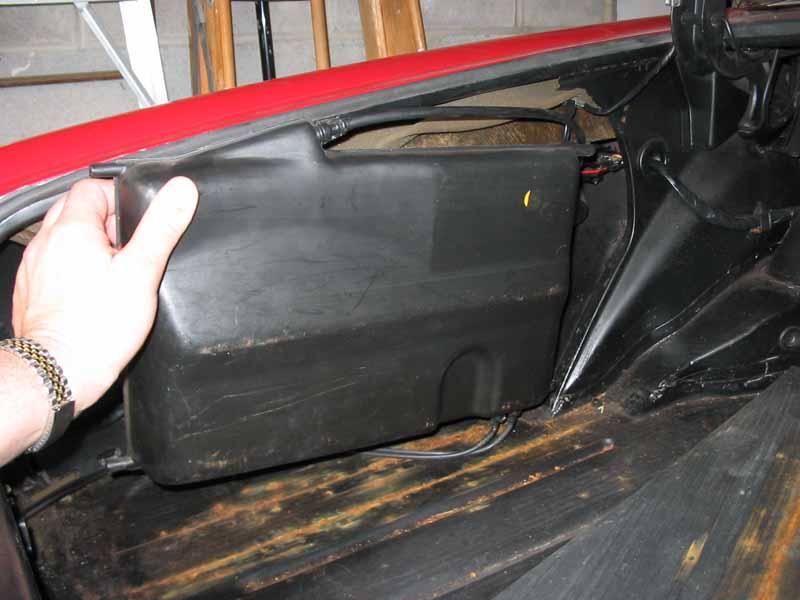

Apparently, there are 2 small/thin plastic lines that run from the gas filler neck to a recovery resevior (big black plastic box) mounted on the driver side of the trunk. This is part of the fuel vapor trapping and recucling system. BBB says this box can actually get partially filled with fuel when tank is full. Well, onme of these 2 lines has a small crack/hole/ And it's right near where the line meets the resevior.
The plastic is reinforced, where the leak is. I don't think I can patch the plastic, nor cover it up with a rummber tume to seal the leak. It looks like these tubes/lines are fused to the resevior.
Do I have to replace the while thing (resevior and 2 lines) as a unit?

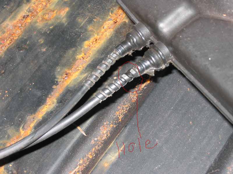

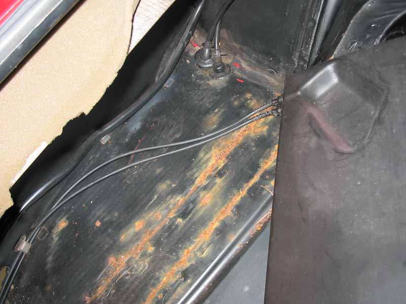

Here's a couple of pictures. I circled the location wit hthe hole. You'll see, it's a pretty tough place to patch up, without fear of it springing a leak soon after...

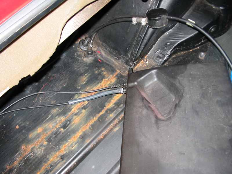

Well, I was reluctant to attempt to repair, as it seems likely epoxy or other fix will leak in the near future. I prefer to fix things relatively permenantly. That's wny I'm waiting on a price for a replacement tank with line from Tom Hansen.
However, I did come up with a possible solution, that just might work. I severed the plastic line about 3 inches from the tank. Then I slipped a 6 inch piece of 1/4 inch diameter rubber tubing over the plastic line. I squished some gasoline tolerant gasket sealant all around the cracked area, then worked the rubber tubing up the plastic line until it totally covered the crack, and butted up against the tank. then I put some gasket sealant on the other end of the plastic line, which leads to the fuel tank, and forced it up the other side of the rubber tubing. I haven't decided whether to use clamps or not. Here's a picture of my possible fix:
